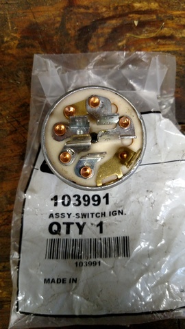

Wheel-N-It 2,978 #1 Posted September 18, 2016 Hey Guys, one of todays Wheel Horse duties was to replace the starter solenoid and ignition key switch on the 418-8. This tractor has a 18hp Kohler Magnum. I have some new Toro switches here that I bought from Dale at the Big Show this year. I really like doing business with Dale, he is a good guy. Anyway, I matched up the old key switch to one of the ones I bought from Dale, part number 103991. Everything plugged up fine and the tractor started right up and ran fine but would not shut down with the new switch. So I put the old one back in and it works fine. The charging system is working correctly with both switches and charges at 14.05vdc. So I guess my question is do I have the correct switch but it is faulty, or is that not the correct switch? If it is not the correct switch, will someone give me the correct part number, and if possible tell me what the 103991 works on. This is a Toro part number. Thank you for any help you can give me. Share this post Link to post Share on other sites

BESTDOGEVER 218 #3 Posted September 18, 2016 I'm pretty sure that is the right switch not shutting down would be a ground issue possibly in the switch itself 1 Share this post Link to post Share on other sites

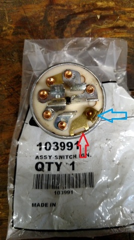

N3PUY 1,031 #4 Posted September 18, 2016 (edited) Just last week I had a Murray that would not shut down. If I wiggled the switch connector it would. It did not have a wire for the ground terminal. (blue arrow). It only grounded thru the switch housing. The problem was that there was no contact with the terminal and housing. (red arrow). With a small hammer I tightened up the connection peening over the housing. Worked fine then. Make sure your Magneto wire goes to the "M" terminal. Edited September 18, 2016 by N3PUY 1 Share this post Link to post Share on other sites
Wheel-N-It 2,978 #5 Posted September 18, 2016 (edited) So should there be continuity between the blue arrow terminal and ground in the off position? I'd be more leaning towards a defective switch too were it not new in the bag and it's Toro to boot. Edited September 18, 2016 by Wheel-N-It Share this post Link to post Share on other sites
N3PUY 1,031 #6 Posted September 18, 2016 Just now, Wheel-N-It said: So should there be continuity between the blue arrow terminal and ground in the off position? Correct! Kinda! The blue arrow terminal is grounded all the time. Either thru a wire or the housing. It's the "M" terminal that is grounded in the OFF position thru the ground terminal. Share this post Link to post Share on other sites
Wheel-N-It 2,978 #7 Posted September 18, 2016 Ok thank you Gents! So as long as you guys think I have the correct switch, then I can try another one as I bought 4 of them from Dale. I wanted to replace the ignition switches on some of the wheel horses with magnum engines, two in particular, this 418-8 and the 416-8. I also bought two other ignition switches from Dale for K engines but have not installed them yet. The part number for those is 103990. Share this post Link to post Share on other sites
mystery_enigma 11 #8 Posted September 21, 2016 Isn't this an 80's model? I'm new here so correct me if I'm wrong. Like you wouldn't anyway. This tractor would not have a magneto so if the switch had an "M" on it then it's the wrong switch. Hold both switches in front of you and see if the same letters are located on the same prong on each switch My guess is your new one has an M. I blew your pic up and it looks like there is an "M" stamped on the top prong. I've never seen one where the letters are on the prongs tho. The wiring plug will match both switches to fool ya... Share this post Link to post Share on other sites
BESTDOGEVER 218 #9 Posted September 21, 2016 You are correct in it being an 80's tractor but it came with the kohler m18qs engine which was magneto fired just solid state which eliminated the points and condenser. I think the mag ground wire goes to that terminal and the switch connects it to ground in the off position 1 Share this post Link to post Share on other sites
Wheel-N-It 2,978 #10 Posted September 21, 2016 23 minutes ago, BESTDOGEVER said: You are correct in it being an 80's tractor but it came with the kohler m18qs engine which was magneto fired just solid state which eliminated the points and condenser. I think the mag ground wire goes to that terminal and the switch connects it to ground in the off position Yes, the 418-8 is a one year only tractor to the best of my knowledge. It runs off a magneto. I think BestDodgeEver nailed it. Share this post Link to post Share on other sites
BESTDOGEVER 218 #11 Posted September 21, 2016 I have a 418A and also am working on swapping the Onan in my 518h for an 18 magnum and the switch is one of the changes necessary as the Onan is coil and trigger fired different switch types Share this post Link to post Share on other sites
