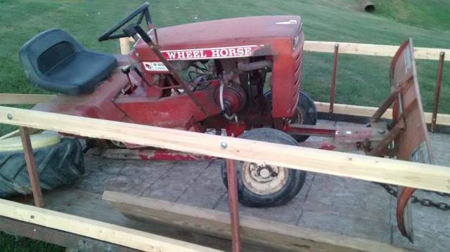

scotty 252 #1 Posted September 14, 2016 I was pushing some brush over with my b-80 and all of the sudden i let out my clutch and it would not move. I started to pull it back to the house and then all of the sudden the wheel fell off. It turned out the whole hub broke.I had to use a winch to pull it on to the trailer. The hub and axle have been bad on this tractor since i got it around 4 years ago. I was surprised it lasted this long. Looks like i have a project ahead of me. Share this post Link to post Share on other sites

953 nut 63,615 #3 Posted September 15, 2016 Look at the bright side; lots of posts pop up here about people who can't get the hub off, yours did it for you. PS; I had one brake on me a few weeks ago, I heard something clanging inside the hubcap, it was part of the hub! It didn't fall off, but came close. 1 Share this post Link to post Share on other sites
scotty 252 #4 Posted September 15, 2016 Haha yeah no fussing with the hubs is a big plus and a couple weeks ago i got the hitch pin free. I think it should go pretty smoothly. Now im going to have to decide if i want to paint it up or not. 1 Share this post Link to post Share on other sites
