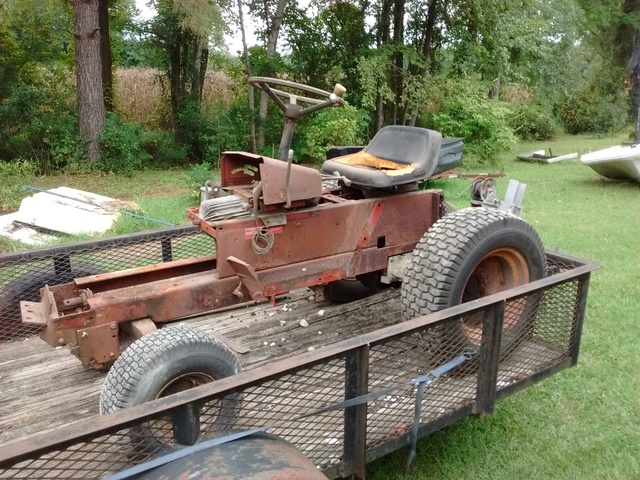

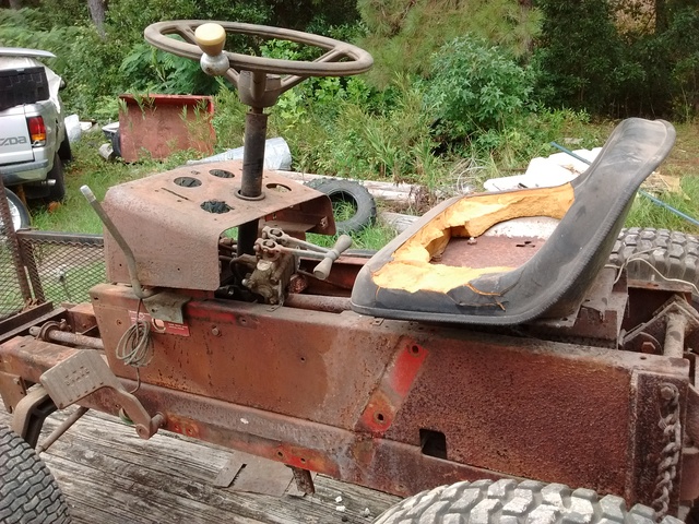

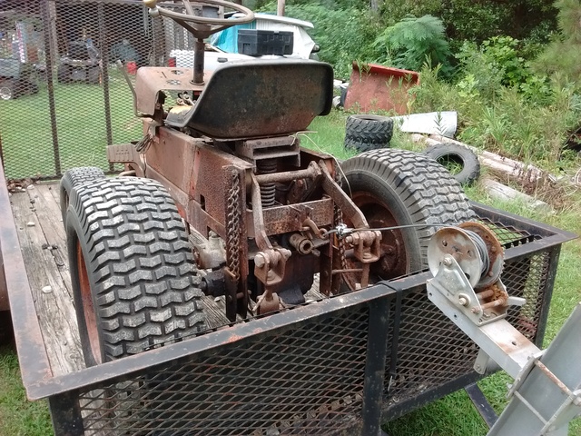

Steve63 4 #1 Posted September 14, 2016 I just acquired a Wheel Horse tractor that I could sure use some help IDing and possible parts. Any help would be great. As you can see, it's disassembled partly for resto. This is how I got it. I know I'm missing the hood. I have to sort out the stuff I got with it to see what else I'm missing. A manual sure would help. 3 Share this post Link to post Share on other sites
stevasaurus 23,618 #2 Posted September 14, 2016 (edited) I think you have a D-200 1978 there. Check out the photo gallery below on the main page. 1978-1984 If in fact it is...here is the manual. Edited September 14, 2016 by stevasaurus 6 Share this post Link to post Share on other sites
953 nut 64,187 #3 Posted September 14, 2016 You are taking on a major project there, but there are lots of awesome members here ready to help with information and advice. 4 Share this post Link to post Share on other sites
KC9KAS 4,746 #4 Posted September 15, 2016 @Steve63 and yes you have a "D" series tractor. 1 Share this post Link to post Share on other sites

WHX?? 55,107 #7 Posted September 16, 2016 2 hours ago, Steve63 said: end result will be worth the investment Truth be told and honest Steve I doubt it unless you have a lot of the stuff that's missing including the motor. This might be strictly a labor of love. Some of the guys here would love to have that 3 point tho! 4 Share this post Link to post Share on other sites
pfrederi 19,936 #8 Posted September 16, 2016 (edited) You would have to find an engine and K twins originally used are hard to find and expensive to fix. The hydro system cannot be assessed until you get an engine or disassemble the hydro. It will be a big and I dare say expensive project. In addition to the three point the rear PTO will bring some money too bad the front pulley is missing. Edited September 16, 2016 by pfrederi 3 Share this post Link to post Share on other sites

Steve63 4 #14 Posted September 20, 2016 I have to rebuild the hydraulic units as dirt dobbers had found open holes to fill so I'll definitely need kits for them. Anyone have any suggestions? The guy who was in the process of disassembling it told me he had taken pics of the process and would put them on an SD card for me. I also need seals in the cylinders under the seat. After I remove those and the rear end, then comes the sand blasting. Just would like a functional tractor, not a show piece. Stevasaurus, as soon as this rain clears out, I'll lay out the other stuff I got with it and submit it. Thanks again. 1 Share this post Link to post Share on other sites
pfrederi 19,936 #15 Posted September 20, 2016 There is no such thing as a kit. Seals and bearings can be had. LJ Fluid power has some parts but be sitting down when it comes to price. There are several how to threads here on overhauling the units. You need to download the sundstrand manual from the manuals section here. LJ Fluid Power 10118 South M 43 Highway Delton, MI 49046-9602 (269) 623-4150 Share this post Link to post Share on other sites
