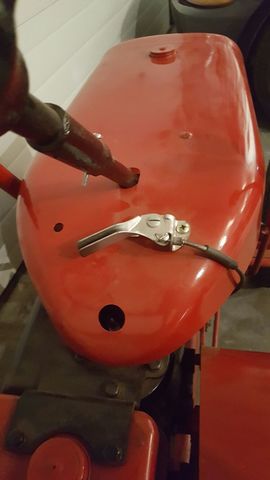

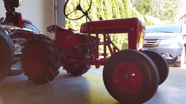

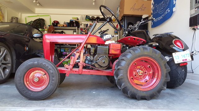

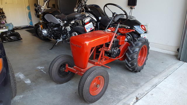

Johnny Canuck 26 #1 Posted September 14, 2016 Hi all! Just joined the Wheel House family over the weekend and I have already learned a great deal from this excellent forum. I think I have a late 1956 or early 1957 RJ-25. It has a Briggs and Stratton model 8 engine but no serial number on the body. It has Wheel Horse embellished on the front and Pond stamped onto the drive train. I have read that there were no Briggs model 8 in 1957 and Wheel Horse was not embellished on the front until 1957. It has been restored so it is possible someone put a different engine and body together. Or could be left over parts being used in the new model year. Any thoughts from your collective wisdom appreciated! Thanks! 10 Share this post Link to post Share on other sites

rj35hunter 308 #5 Posted September 14, 2016 Looks like a 56 for sure, if that's the original hood it's probably a later 56 RJ35 that originally came with a Clinton 1200 more than likely and won't be a RJ25 since the RJ25 did not have a hole for the gas cap since it was mounted to the engine. The engine looks like the type used but hard to know for sure if it's original. What does the back of the hood look like?....small hole for kill switch or larger hole? I just recently finished restoring my 1955 RJ25 and did a lot of research and studying on it and there is little to no facts and info on the RJ25....so all of this is my opinion. What is your plans with it? Clay 6 Share this post Link to post Share on other sites
Johnny Canuck 26 #6 Posted September 14, 2016 Thanks for the info Clay. I was thinking it was an RJ-25 because of the Model 8 engine. The engine is type #: 107133 and serial #: 74997L. I am attaching a pic of the back of the hood. I basically bought it because it looked so darn cool. I thought it would be fun for me and the kids to putter around in. Maybe put a wagon on the back or actually find a mowing deck and put her back to work! 5 Share this post Link to post Share on other sites
