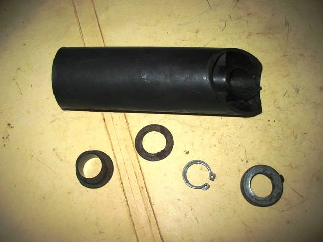

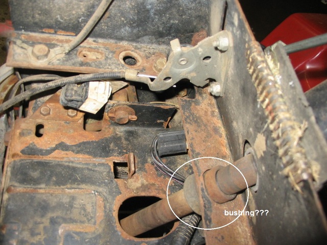

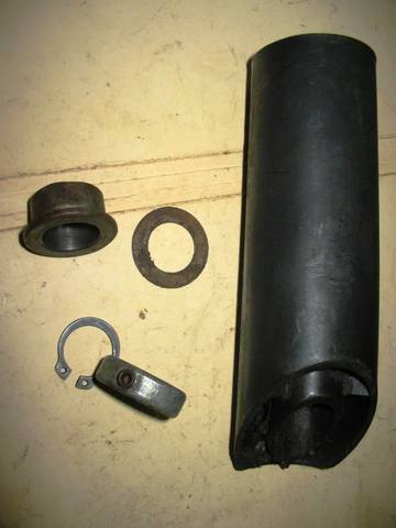

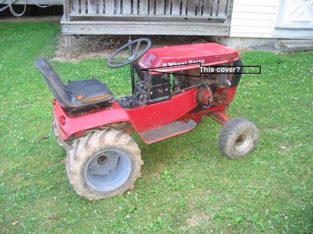

daveoman1966 3,884 #2 Posted September 13, 2016 (edited) Here is my 314-A. This the bushing you want? and the Steer column cover too? ? ? I have both..... for details and pics, send me an off-site email. I just went out and took some pics of the parts me thinks you want....here they are: I am: daveoman@windstream.net Edited September 13, 2016 by daveoman1966 1 Share this post Link to post Share on other sites
Jays308-8 10 #3 Posted September 13, 2016 The cover and bushings are exactly what I'm looking for. It seems that the shaft was taken apart at one time and put back together incorrectly. If you would have an exploded view of the assembly, that would be great. Otherwise I could look at a diagram on partstree. PM me with the price you want for the parts. Thank you! Share this post Link to post Share on other sites
Ed Kennell 47,237 #4 Posted September 13, 2016 Jay, The purpose of the bushing of course keeps the shaft centered, but more importantly, it also takes the up thrust of the steering gear that wants to disengage. The bushing must be installed with the flange down and below the metal support plate to keep the gears tightly engaged. Share this post Link to post Share on other sites
Jays308-8 10 #5 Posted September 14, 2016 12 hours ago, Ed Kennell said: Jay, The purpose of the bushing of course keeps the shaft centered, but more importantly, it also takes the up thrust of the steering gear that wants to disengage. The bushing must be installed with the flange down and below the metal support plate to keep the gears tightly engaged. Thank you. It was installed correctly, but had an issue where the steering shaft had a lot of play. Also, the shaft cover would never stay in place and over time, the dash decal got torn up and the inside of the cover got destroyed. I'll be looking for some more pics of the bushings and clips that keep the steering shaft centered. Thanks for the quick responses, you guys are great! 1 Share this post Link to post Share on other sites
