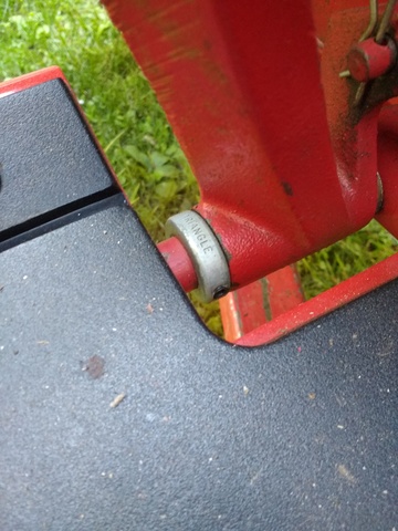

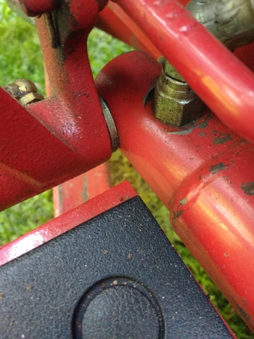

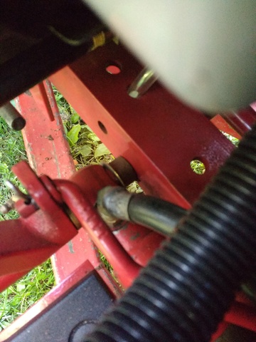

rmaynard 16,771 #2 Posted September 12, 2016 (edited) I don't know if this will help you, but here are some pictures of my '96 416-H brake pedal/lift cylinder setup. This is the only way I could install the hardware to keep things lined up and not rub. From outside to frame, in that order: Edited September 12, 2016 by rmaynard Share this post Link to post Share on other sites
Detector 72 #3 Posted September 12, 2016 Yes very helpful & Thank you for taking the time to take the pics!! Everything on mine lined up fine prior to dissambly and I see no wear on the cylinder closest to the frame so I may roll with it like it was prior to disassembly. Share this post Link to post Share on other sites
