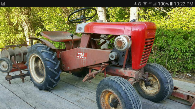

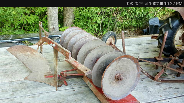

Trap79 2 #1 Posted September 12, 2016 I'm looking at an old 502. It comes with a single plow. I was wondering if that would have enough power and weight to plow some small food plots? This land hasn't seen a plow since the 60s. I did use a rototiller on the plots last year but I didn't go to deep. I'd sure appreciate some input from folks who know these machines. Thanks. 2 Share this post Link to post Share on other sites

slammer302 2,157 #7 Posted September 12, 2016 I have a 502 that I've plowed with before. It got the job done but it worked slow not near as fast as my commando 8 that I normally use my plow on. I used the same 502 yesterday for blading a gravel drive way it worked well I do have wheel weights on the back with ag tires 2 Share this post Link to post Share on other sites
T-Mo-(Moderator) 4,890 #8 Posted September 12, 2016 I think if it's a 8 inch plow, it will do better. If it's a 10 inch plow, then it will struggle some. Also, ground conditions play a big part in plowing. If it's wet, then it will have a hard time. If it's a sandy type and dry, but not too dry and not packed hard, it will do better. 1 Share this post Link to post Share on other sites
