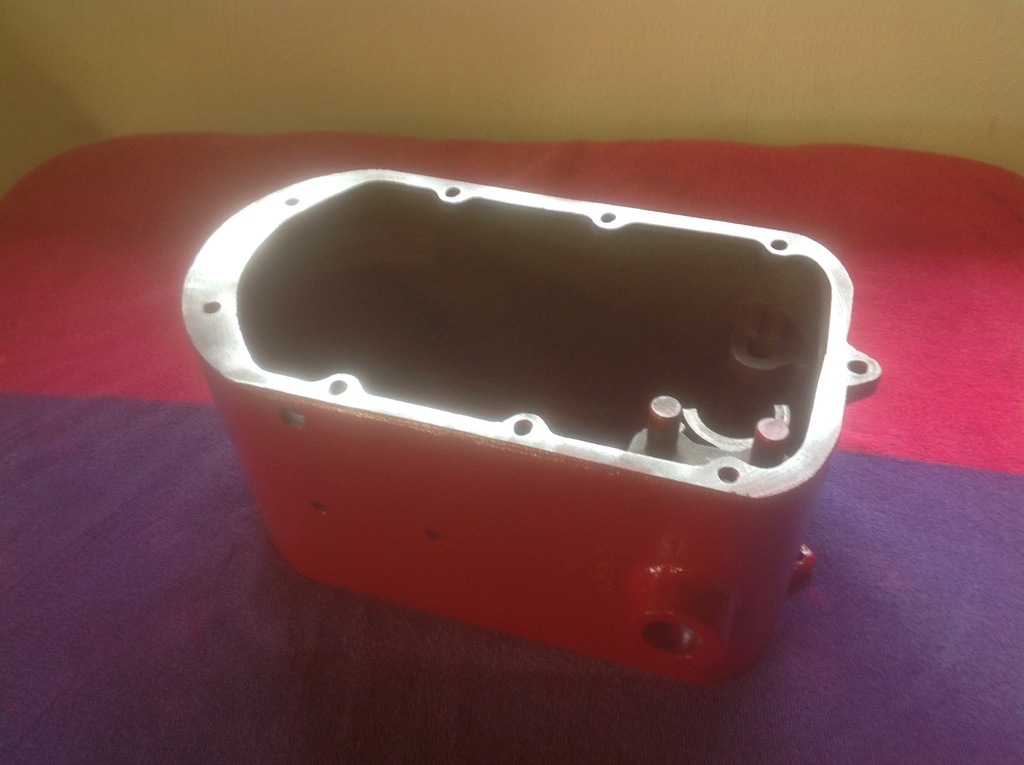

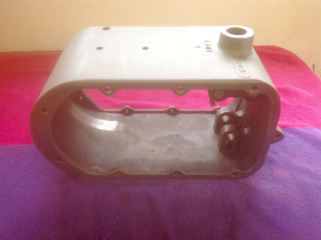

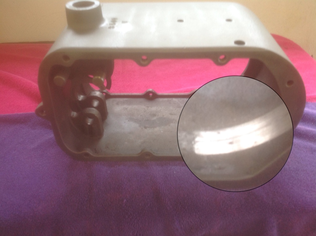

slim67 2,825 #33 Posted January 21, 2017 after looking further at wear marks at back of trans case, im thinking the bronze bushings inside the carrier have worn excessively ? allowing enough play for ring gear to hit case? 1 Share this post Link to post Share on other sites
953 nut 70,542 #34 Posted January 21, 2017 1 hour ago, slim67 said: bronze bushings inside the carrier have worn I saw one so far gone the axle housing that holds the bushing was half worn through, had to ad a bit of shim stock behind the new bushing. Share this post Link to post Share on other sites
slim67 2,825 #35 Posted January 22, 2017 1 hour ago, 953 nut said: I saw one so far gone the axle housing that holds the bushing was half worn through, had to ad a bit of shim stock behind the new bushing. I pressed out the old bushings in the carrier and am looking for replacements. The bushings in the axle tubes looked decent but I would replace them to if I can find them. I reading through the threads on the #5010s. Im hoping they arent going be hard to find. What do you think? Share this post Link to post Share on other sites

953 nut 70,542 #37 Posted January 22, 2017 Have you read over the "Save a three piece" thread, I think Steve had parts sources in it. If not you could PM him and get lots of help. Share this post Link to post Share on other sites

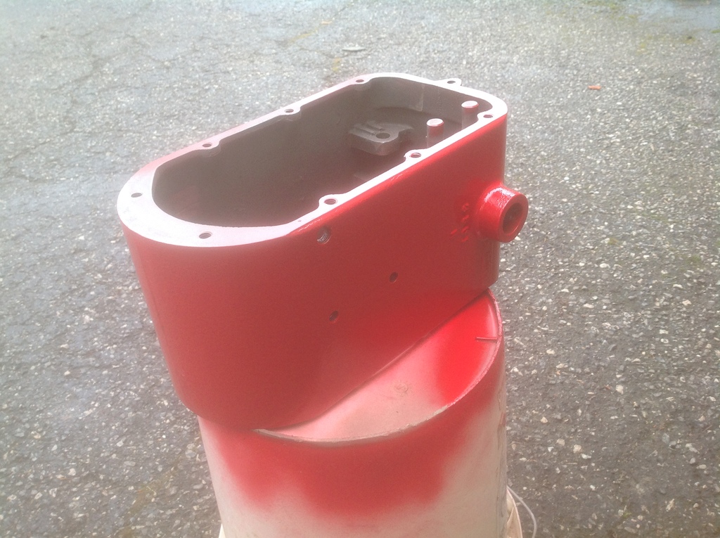

slim67 2,825 #41 Posted January 22, 2017 I finished the gear box and am ready to move onto the side covers. I hope to be reassembling this very soon thanks to Redsquare. 2 Share this post Link to post Share on other sites

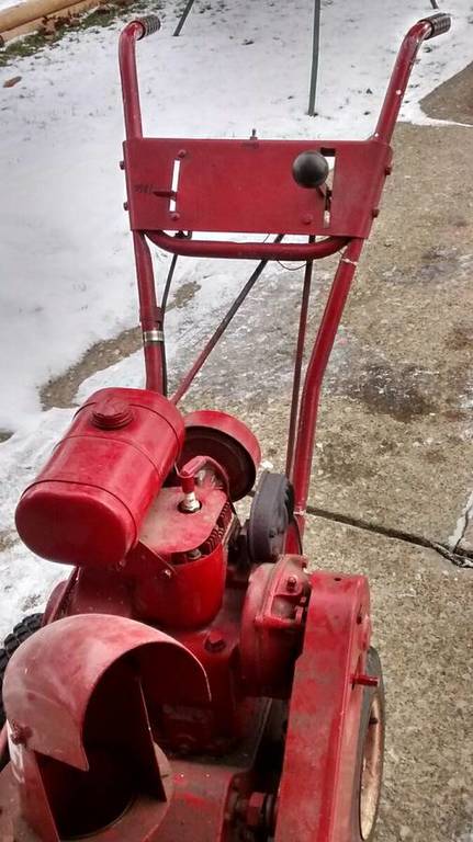

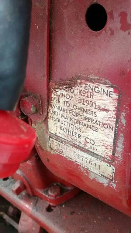

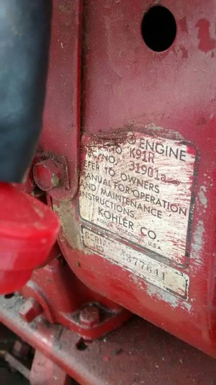

slim67 2,825 #42 Posted January 22, 2017 (edited) Here's a K91R on a snowblower just like a two wheel Chief walk behind I had years ago. The guy wants 225 for the unit. It has the reduction box mounted on the side which I believe can be removed so you can use engines output shaft instead. Edited January 22, 2017 by slim67 Share this post Link to post Share on other sites
Howie 900 #43 Posted January 22, 2017 If the Kohler is like any other engine with the gear reduction box you will need a different crank. All I have seen have a short explained shaft. Have not pulled one of the Kohlers apart so I could be wrong on this. 1 Share this post Link to post Share on other sites
slim67 2,825 #44 Posted January 22, 2017 38 minutes ago, Howie said: If the Kohler is like any other engine with the gear reduction box you will need a different crank. All I have seen have a short explained shaft. Have not pulled one of the Kohlers apart so I could be wrong on this. I removed the reduction box off the Kohler I had for some reason but I dont remember what the shaft length was as that was 20 years ago. What you are saying probably holds true since the engine was specd for the box. I am guessing that the R in K91R could stand for reduction? I will probably not be going with a K91 unless I buy the other tractor from the guy I got this one from. I havent got to that point yet. Maybe I can stuff a Vanguard in there ! Good point on your post Howie. Share this post Link to post Share on other sites

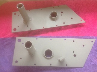

slim67 2,825 #45 Posted January 23, 2017 I had time to get the side covers cleaned up and primered. All seals,bearings and bushings have been removed. Overall I am pretty confident that this trans will be reusable for pull cart but Im not planning on any severe duty stuff. The trans gears are all in good shape and there was no rust inside the case when I opened it. Previous pics show heavy oil sludge coating everything even though there was some water when I drained it. The worst thing . I noticed is some chipped teeth on the ring gear,a couple of the spider gears and one of the axle gears while disassembling the diff for inspection.This trans has been repaired at some point in its life maybe even rebuilt? There is signs of axle tube weld build up on one cover. You got appreciate the fact that 57 years ago a guy like one of us assembled this thing with very basic parts and technology and its lasted to this day. Made in the USA ! 1 Share this post Link to post Share on other sites
