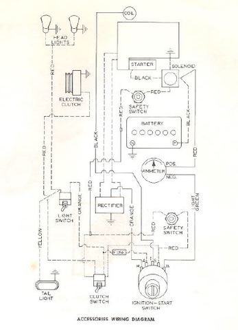

pfrederi 19,278 #6 Posted September 11, 2016 16 Auto wiring Whole manual is here http://www.wheelhorseforum.com/files/file/1876-tractor-1973-auto-10hp-12hp-14hp-16hp-automatic-om-wiring-snpdf/ 1 Share this post Link to post Share on other sites

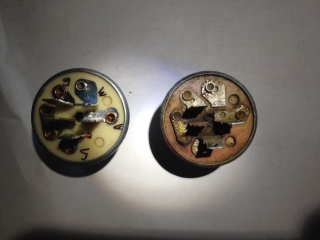

pfrederi 19,278 #12 Posted September 11, 2016 (edited) 7 minutes ago, Woodsman said: Yes the old switch was original and worked well until I broke it. It had all the same markings on the polls as the new switch. This is on a 1973 16 Auto. If that is absolutely true then something has been hacked over the years. Can you post a couple pictures of your motor?? and teh switches old an new?? Edited September 11, 2016 by pfrederi 2 Share this post Link to post Share on other sites
953 nut 63,089 #13 Posted September 11, 2016 Here you go! 1 Share this post Link to post Share on other sites
Woodsman 3 #14 Posted September 11, 2016 Here's the new & old switches Share this post Link to post Share on other sites
pfrederi 19,278 #15 Posted September 11, 2016 I cannot see anything on teh old switch...however just because the pin pattern is the same doesn't mean it is the same switch. Are you reading the letter stamped into the terminal or going by a diagram??? I note the upper right terminal on the old switch seems to be missing...That could have been a "I" terminal not an M. Where di you get the new witch from?? 1 Share this post Link to post Share on other sites
Woodsman 3 #16 Posted September 12, 2016 The old switch did have an M on the missing blade. I'd marked the side of the cylinder with a sharpie for all blades before I broke the M off. I picked up the new switch off eBay from a reputable Toro dealer. It came in a sealed Toro package. My test light indicates I have it connected properly, yet I keep getting continuity between the open points when it's all together. Im about ready to try a simple hotwire to see if the problem persists. Share this post Link to post Share on other sites

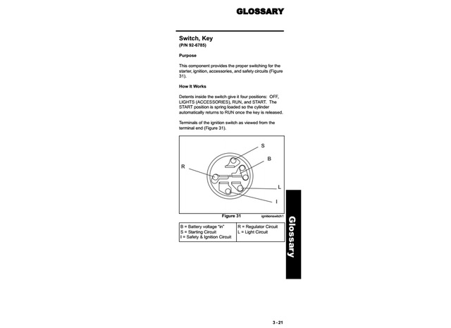

N3PUY 1,031 #22 Posted September 12, 2016 Woodsman, All you need is the correct switch! The "M" terminal goes to ground inside the switch. There's no need for that on a tractor with points and coil. Unless you want to start a fire! Get the switch for points ignition. So the old switch was for magneto ignition .... you don't have magneto ignition. Just forget you ever saw that switch. Get a switch with B, S, I, A, and R. Simply put..... a wire from the battery "+" terminal to the "B" on the switch, a wire from the "S" term on the sw to the small term on the solenoid, a wire from the "I" term on the sw to the "+" on the ign coil, a wire from the "A" term on the sw to the light switch, a wire from the "R" term on the sw to the "B+" term on the regulator. Turn the key and off you go! You might want to add a few safety switches and fuses. Here's a pic of the 2 switches. Look at that... the switch on the left for magneto ignition has a terminal stamped "M" where the "G" terminal should be. And the stamp on the terminal in the "M" position has a "G" stamped into it. I guess you can't go by terminal markings! BUT you do need a switch with an "I" terminal. 2 Share this post Link to post Share on other sites

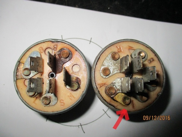

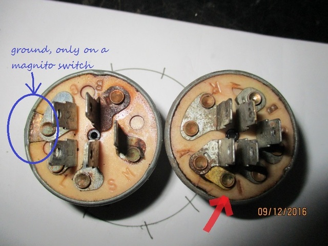

N3PUY 1,031 #23 Posted September 13, 2016 I just noticed something .... neither of your switches have a "ground" connection. Look for markings on the terminal plate, not the terminals themselves. I think you may have the correct switch! See the left switch. Share this post Link to post Share on other sites
wallfish 18,791 #24 Posted September 13, 2016 So one reason I don't believe the 92-6785 switch Woodsman has is correct, from this Partstree page for the applications of that switch part number. http://www.partstree.com/parts/toro/parts/92-6785/ All of those tractors listed are magneto ignition engines. Guess there must be a typo somewhere????? Another reason is the picture of the new 92-6785 switch posted by Woodsman does not match the switch terminals in the demystification link picture Gary posted, which does show the correct terminals the correct switch should have. Mystified! For a quick solution until you can get a new correct switch, pry the edge of the lip up around the terminal plates to remove them. If the old switch needs cleaning, now is the time. Do the same to both switches and swap the terminal plates of the switches keeping the position of the terminals the same. Then tap the lip back down to hold it back together. Nothing to loose since you need a new switch anyway!. I have opened them up numerous times to clean contacts inside when a switch fails and there's really not much to it. Just go slow when opening them so the springs don't get lost. If successful, you won't need to buy another new switch and you are right back to using your original switch so there is no question about the right switch any more. Share this post Link to post Share on other sites
gwest_ca-(File Mod) 11,852 #25 Posted September 13, 2016 The switch on the right N3PUY posted looks like the 103990 5-terminal 3-position key switch. The 2nd screen shot is the better picture. I only looked at one of the wiring diagrams for a 2002 model 268-H that also uses the 92-6785 switch and it has magneto ignition as stated by Wallfish. But it also has a kill relay powered by the "I" terminal of the battery ignition switch which opens the relay contacts so the motor will run. Ignition turned OFF and the contacts close on a ground contact. Garry Share this post Link to post Share on other sites
