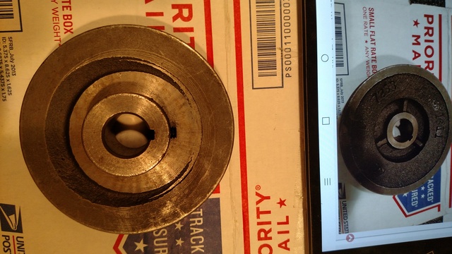

Wheel-N-It 2,978 #26 Posted September 20, 2016 Kind of a strange cut in the back side but here it is. What do you think Steve? 1 Share this post Link to post Share on other sites
stevasaurus 23,716 #27 Posted September 20, 2016 WOW...so that is what you are talking about in the PM?? 1st off, it looks like a reject that got out of the scrape pile. Is the hole in the center? Maybe we need to confront this guy and find out where he got all of these pulleys. Van...it is hard to tell from a picture...what do you think?? I have pointed some guys in this guys direction, and I have not had any feedback (good or bad). I'd like to take a closer look at this pulley, or have you take a closer look at it Van. Did you talk to this guy at all?? Let me know. Share this post Link to post Share on other sites

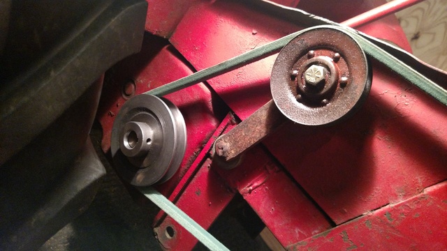

Wheel-N-It 2,978 #28 Posted September 22, 2016 (edited) Well tonight I got the pulley installed after much sanding and polishing of the transmission shaft, and grinding and polishing of the keyway. Tomorrow I need to stop by the auto parts store and purchase some blue Loctite for the Allen head set screw. Also reinstalled the tensioner pulley after letting it set in some LE oil for about a week. The bearing in it is nice and smooth now, a big difference from when I removed it. I'm looking forward to a test-drive. Also want to say Thank You to Steveasaurus for several nights of phone time and much needed good advice. Edited September 22, 2016 by Wheel-N-It 3 Share this post Link to post Share on other sites
stevasaurus 23,716 #29 Posted September 22, 2016 Van, that wheel looks great in that shot. 1 Share this post Link to post Share on other sites
