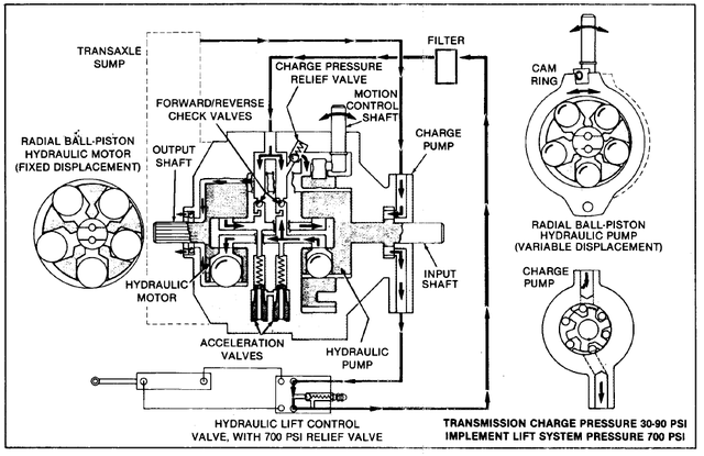

bmsgaffer 2,054 #8 Posted September 11, 2016 (edited) 4 hours ago, JAinVA said: Extra filters are always good but I question the the need for a filter in the bypass.Most of the wear is in the gear and pump systems of the transmission.If you have the ability to install a filter in the return line so much the better but in my opinion the stock filter arrangement will supply suffient protection.If you can't put a filter in the bypass I wouldn't sweat it.JMHO,JAinVA I should have clarified. The stock filter IS in the return line from the lift system on an eaton 1100, that is all I was referring to. So it would have to be attached to the "bypass line" as it were. Not adding an extra one. On this system you have to have the lift accessory circuit connected to charge the drive system (and to not make the charge pump self destruct), but you can leave out the lift valve and cylinder. Just go straight from charge pump to filter back to hydrostat port. Handy dandy diagram for eaton 1100: Edited September 11, 2016 by bmsgaffer 2 Share this post Link to post Share on other sites
