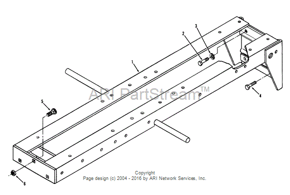

Take a look at the parts pages for each. As an example, here is the frame from a 1979 C-121.

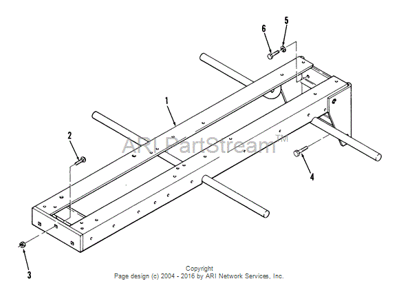

And here is the 1977 C-120 frame
Hole patterns are different, and the C-121 has additional rods sticking out the sides. As far as the footrests, they are different as well.
It's your call. If you want to try the swap, more power to you, but I'll stick with my previous comments.
