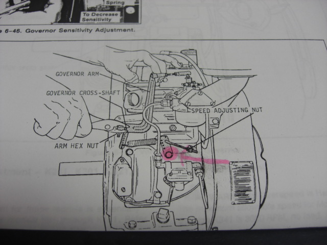

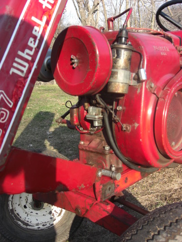

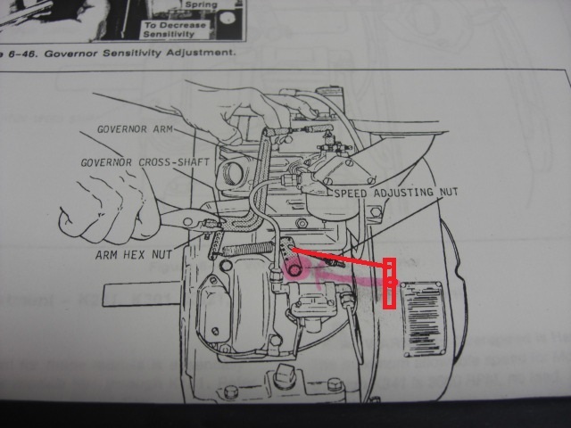

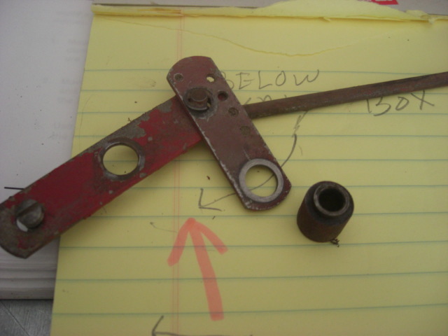

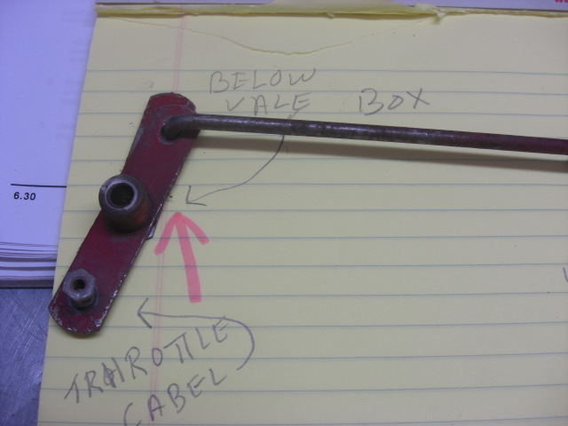

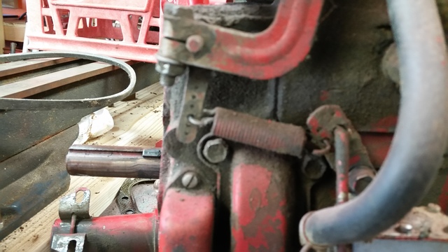

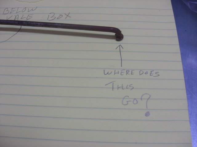

Retired Wrencher 6,572 #1 Posted September 9, 2016 Hi I have this on 10hp 1967 model . I think I know where most of it goes but there are a few questions. The shaft that bolts to the boss area under the valve box where does that hook up to and there dual tabs? one with 4 holes in it do I need this? here the pick`s that I have. Thanks for any info. Share this post Link to post Share on other sites
WHX?? 56,030 #2 Posted September 9, 2016 I can get a few pics of my 1067 setup for you if you need. It looks a lot like your 1st pic I think. A 1267 should be real similar. Share this post Link to post Share on other sites

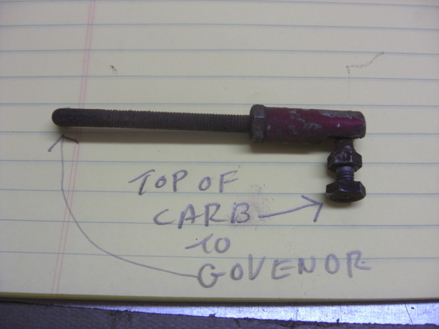

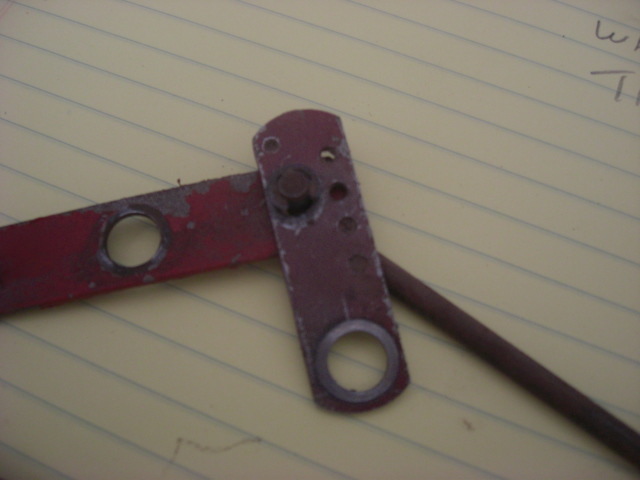

wallfish 19,723 #4 Posted September 9, 2016 The carb link you have correct. The other piece is used to change the direction for the throttle cable to pull from the shaft side of the engine. Mostly push/pull controls. 2 Share this post Link to post Share on other sites
Retired Wrencher 6,572 #5 Posted September 9, 2016 Thanks John I found it on my 1st 1257 that I had Wheww. I think this solve the Mystery. Glade I took pictures. Thanks for the post guys .Always glad for the helping hand. Share this post Link to post Share on other sites

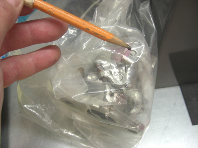

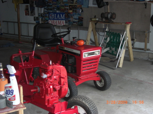

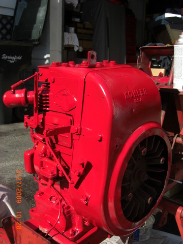

Retired Wrencher 6,572 #6 Posted September 9, 2016 (edited) Well I got this from my second 1057 that I had From Suffield CT. What sweet running engine that was. Sold it So that is it. The 1257 that I have now has only the top linkage on it? Edited September 9, 2016 by T1257 RETIRED WRENCHER. Share this post Link to post Share on other sites
