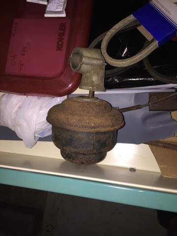

Got this oil bath yesterday
RedHorse54
I picked this up yesterday. How much oil goes in these? Should I fill it up with oil to where it says "oil level"? Thanks

rj35hunter
Yes that's where I put all of mine is the oil fill level.....I just use straight 30 like I put in the engine.

wallfish
VERY Nice find!!! Those updraft filters are much more rare than the downdrafts are.

Thanks guys :)
