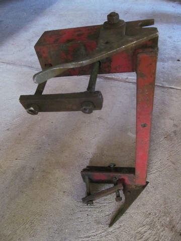

Ed Kennell 43,168 #9 Posted September 6, 2016 Here is a pic of one style of axle bracket to give you an idea. Not sure you want to manufacture on of these when there are available for $30-$60. If you want to go cheap, you could make a bracket from two pieces of 2X2 angle bolted to the axle with a hole for the plow pin. You would have to remove one rear wheel to install the pin when installing or removing the plow frame. 1 Share this post Link to post Share on other sites
