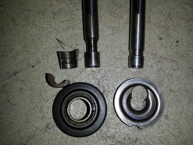

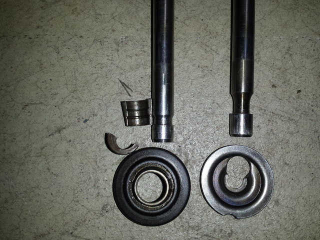

moe1965 774 #1 Posted September 2, 2016 (edited) I bought a sb 421 with a 11 hp briggs. The guy I bought it from rebuilt it but never completed it 100 percent so I guess you could say I bought a basket case. I reassembled the rest of the external parts of the engine. I ran it for 6 hrs and it quit. Here is what I found. One if the retainer clips came off. It was on the exhaust side. I couldn't get the retainer back in place. I took the valve and retainer to a mower shop and they said it was the wrong retainer for that valve. Long story short the retainers were on the wrong valves. The exhaust side retainer doesnt even fit on all the way as it should not being a matched set. That is valve and retainer. It must of held on with the spring presser half cocked until it gave up last night. The first picture is the proper way and the second is the wrong way going from top to bottom. Edited September 2, 2016 by moe1965 Share this post Link to post Share on other sites
