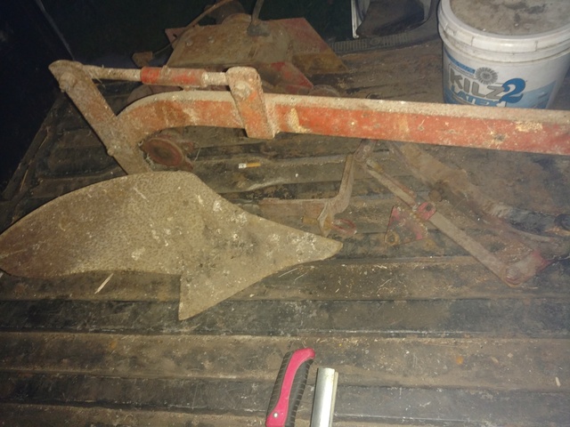

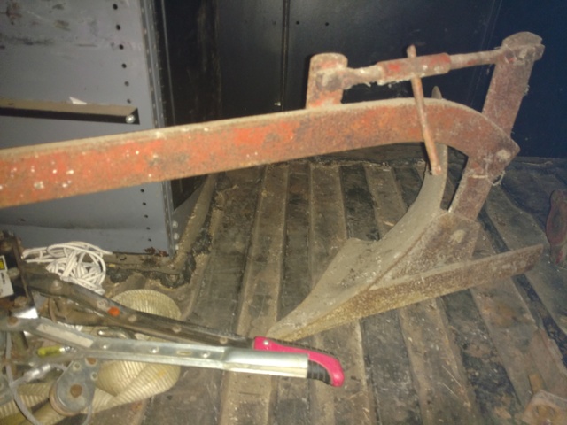

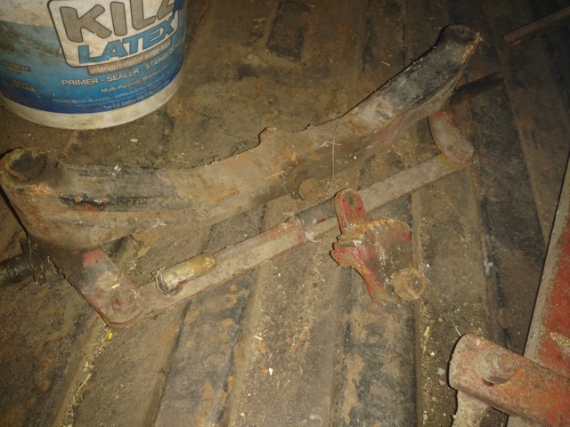

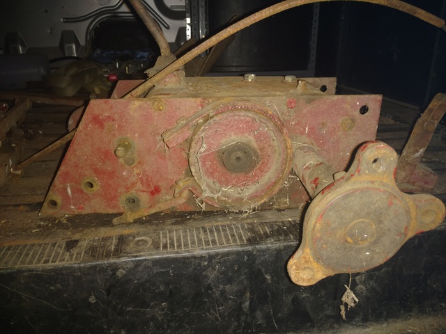

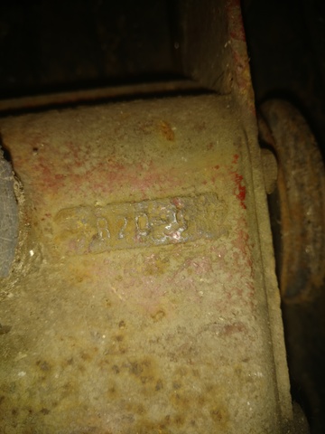

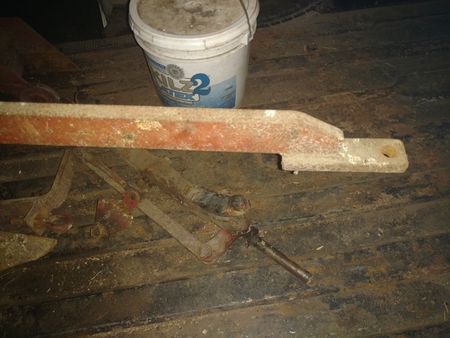

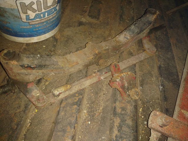

Chris G 3,369 #1 Posted September 2, 2016 Picked these up for $75 What ya think and any ideas and exacts on years? 1 Share this post Link to post Share on other sites
russellmc301 601 #2 Posted September 2, 2016 the tranny 50 frount axle 40 plow 50 thats how much i would give, that plow is somthing i have been hunting for. so great finds. 1 Share this post Link to post Share on other sites
Chris G 3,369 #3 Posted September 2, 2016 Thanks and ya I originally went for the plow myself. I'll keep ya in mind if I find another one. 1 Share this post Link to post Share on other sites
WHX?? 55,184 #4 Posted September 2, 2016 Good find..... might be some good parts hidden in the tranny Share this post Link to post Share on other sites
stevasaurus 23,619 #5 Posted September 2, 2016 The transmission is a Wheel Horse #5010. It was used on the 1960 and 1961 suburbans. The 1960 400, 500 and 550 and the 1961 401. The plow is from the same years, but will work on anything with a slot hitch. That trans may be in good shape. It does not look like it has been sitting outside. Pull the shifter and you can "kind of" get a look inside. See if you can turn the input pulley...counter-clockwise...and shift into the gears. If you want to drain it, back out one of the bottom back side-plate bolts...no drain plug on these. 2 Share this post Link to post Share on other sites
Chris G 3,369 #6 Posted September 2, 2016 (edited) Thanks for the info! Looks like i got to find the rest and build a suburban now! But the transmission works great. No leaks and shifts in all gears and works properly. All the parts were stored in a barn since the 80's Edited September 2, 2016 by Chris G 1 Share this post Link to post Share on other sites
stevasaurus 23,619 #7 Posted September 2, 2016 (edited) It may have some water in there, just from condensation. Take out one of those bolts on the top and stick in a long something that will not break (coat hanger) and see what the oil looks like. If it is milky, it has water in the oil. Edited September 2, 2016 by stevasaurus 1 Share this post Link to post Share on other sites

Chris G 3,369 #10 Posted September 2, 2016 (edited) I as well never heard of a 500. But I figured it was a typo. But I opened the rear end up on one side and all was well. Except the fact someone filled the inside with grease. Never seen that before. But on a better note, the guy called me and said he thinks he found the rest of the tractor!!! And it's mine to come get if I want it. So I'll keep y'all posted with pics as soon as I find out for sure. Edited September 2, 2016 by Chris G 2 Share this post Link to post Share on other sites

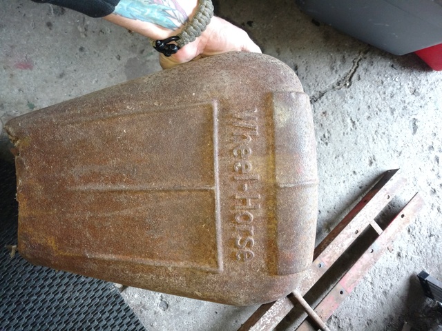

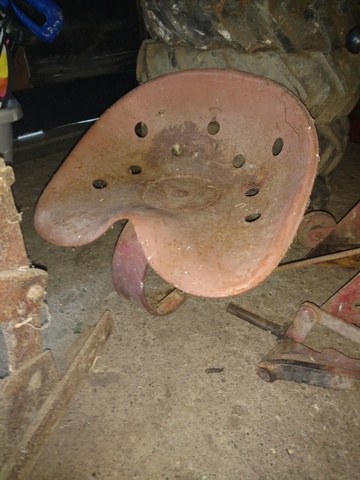

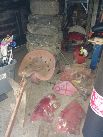

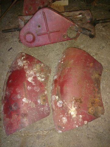

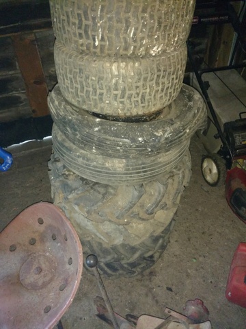

Chris G 3,369 #16 Posted September 14, 2016 Well I got time to go get the rest of the stuff from the guy. And heres all of what o got. On top of what was already posted I got theses. 2 solid front rims with junk tires. 6 solid rear rims. 1 set of the ag tires is usable and the 2nd maybe with tubes.Also the belt guard, seat bracket with seat and the fenders. 2 Share this post Link to post Share on other sites
CasualObserver 3,414 #17 Posted September 14, 2016 Well, it looks like you're just missing the frame, tool box, hood stand and hood to have a complete tractor. Just add an appropriate engine. Is this stuff just loose in a barn or something? The rest of it's probably there somewhere unless it was cannibalized for the steel. You're not missing much more. 1 Share this post Link to post Share on other sites
Chris G 3,369 #18 Posted September 14, 2016 Well he had the rearend, plow and front end on Craigslist and I went and bought it for $75. I told him if he came across anything looking like wheel horse call me. Well he called and said he found the rest pictured over at his dad's place. So I went and picked those parts up and have him pics of the rest missing and told him of he finds those parts or anything wheel horse I will take it most likely. I guess they had a suburban and a bunch of parts. Now I'm just slot getting them as they clean out! 1 Share this post Link to post Share on other sites

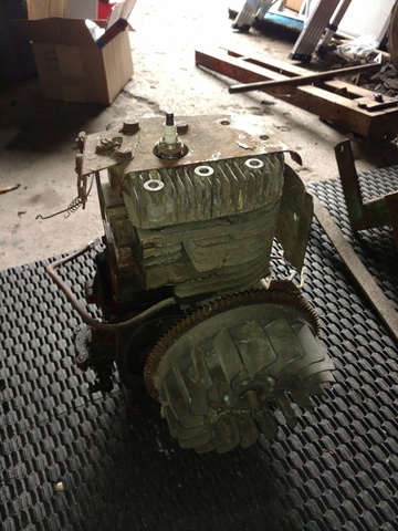

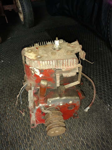

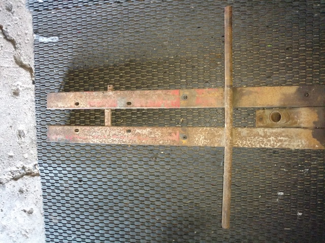

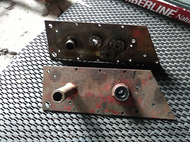

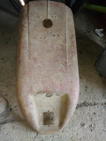

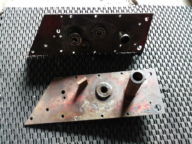

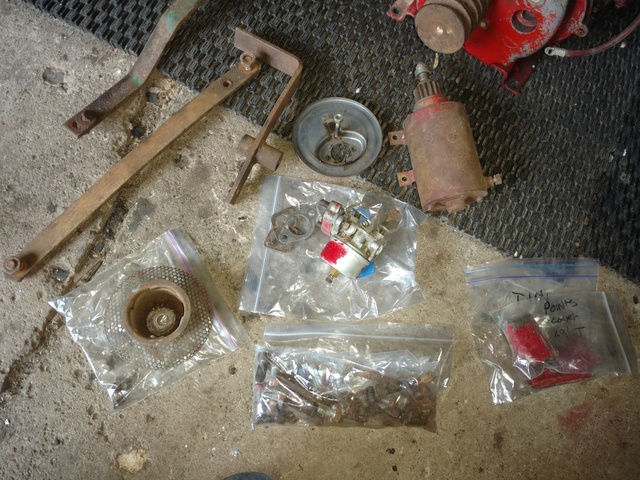

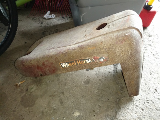

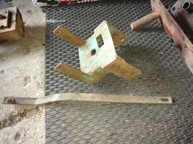

Chris G 3,369 #20 Posted October 9, 2016 (edited) On 9/28/2016 at 9:08 PM, Chris G said: Well I picked up some more stuff today to put towards the suburban pile of parts! Soon I'll have enough to build a complete suburban I'm thinking. I got a hood, frame, brake pedal, some steering parts, transaxle side plates, plow bracket and lift arm. Also a H55 Tecumseh. At least that's what I'm told it is. But I'm not to good at identifying exacts on the Tecumseh/ Lauson engines. Edited October 9, 2016 by Chris G 1 Share this post Link to post Share on other sites
