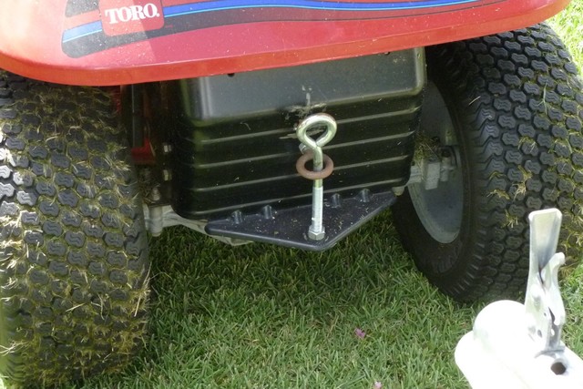

Dave's 854 75 #1 Posted September 1, 2016 I use a long shank eye bolt because I cant find a 2 inch ball with such a small shank. For small trailers at low speed only. 1 Share this post Link to post Share on other sites
Digger 66 3,488 #2 Posted September 1, 2016 Welcome aboard . Perhaps you could mock up a piece of 1/4" flat plate using the existing hole for an anchor point & butt it up to the backside for when you're stopping . Looks like it's chewing the heck out of that rear pan . If it's for light duty only . Just a thought . 6 Share this post Link to post Share on other sites

cschannuth 3,819 #4 Posted September 2, 2016 An 1 7/8" ball will work for a 2" coupler safely for low speed maneuvers and you can get a smaller shank. I move my 18' car hauler around my place with no issues. 4 Share this post Link to post Share on other sites
tunahead72 2,581 #5 Posted September 2, 2016 Ooh, I like that idea! Off the top of your head, do you know how big a shank supports a 1-7/8" ball, and will it fit inside the hole at the end of a standard 300 series drawbar? Share this post Link to post Share on other sites
Dave's 854 75 #6 Posted September 3, 2016 I was unable to find a ball with a shank less than 3/4. Also, I needed some height so I could lower the trailer onto the (ball) using the tongue jack. As you can see, the drag causes the eyebolt to rotate aft, so I used another eye to stop that. Share this post Link to post Share on other sites
