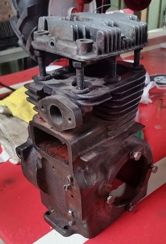

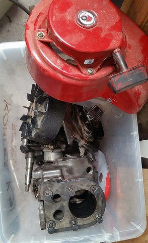

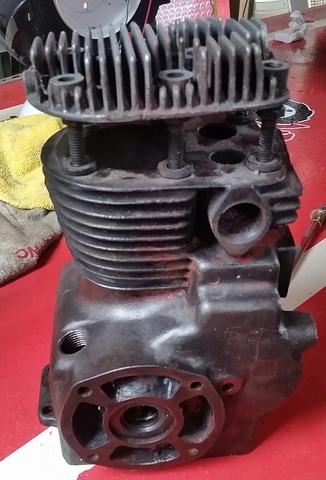

Texas Todd 1,025 #4 Posted August 26, 2016 Pics of block and the engine as is. No sign of any of the parts for a governor. The housing says K-91 as well. If you have pictures of what I am looking for I would appreciate it (or a line on a source) Thanks! Share this post Link to post Share on other sites
