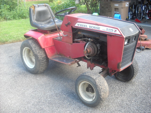

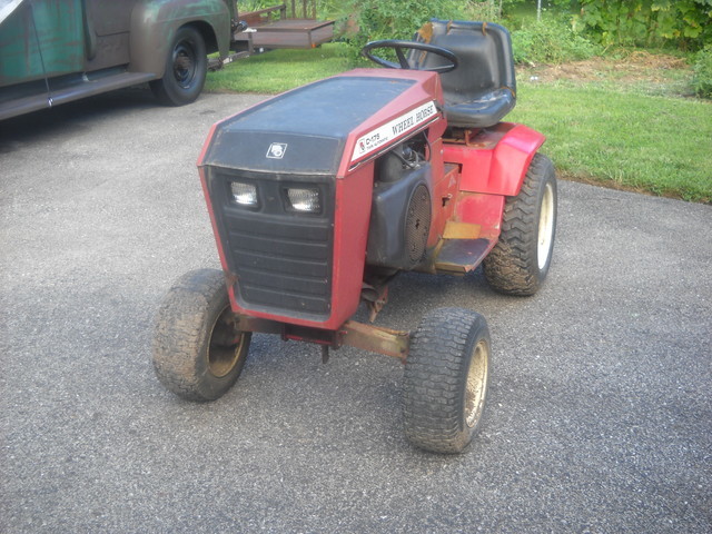

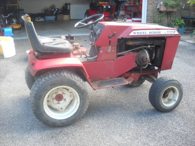

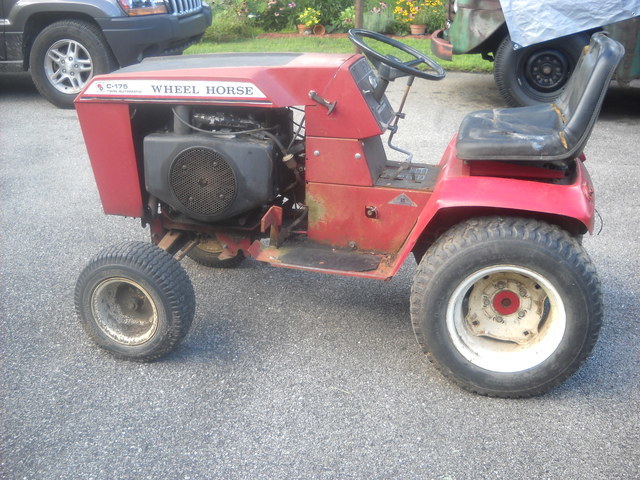

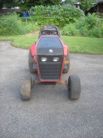

jdleach 525 #1 Posted August 21, 2016 Have brought the C-175 home, and in spite of the sorry state of the machine, I am both hopeful, and tickled. Without further ado, here are photos of the tractor freshly unloaded from the trailer. Thing was sitting in a mud hole beneath a bunch of trees, and certainly looks it. Mud, bugs, leaves, and twigs pretty well cover everything, along with some moss starting from the damp. First order is to wash it down to make it bearable to look at. Since the weather is supposed to be sunny and dry for the next few days, will leave it outside the garage to thoroughly dry out. Will then start making runs to the hardware store and NAPA to begin the process of bringing this beast back to life. 12 Share this post Link to post Share on other sites

JERSEYHAWG / Glenn 4,531 #3 Posted August 21, 2016 JD, very nice specimen to start with, I will be following along. Best of luck. Glenn 2 Share this post Link to post Share on other sites
MountainTopHunter 19 #4 Posted August 21, 2016 Nice tractor JD. I love the sound of those twin cylinder Kohler's. I have a C-175 identical to yours that I am in the process of restoring now. I am putting the engine back together and doing the valve job this week. 2 Share this post Link to post Share on other sites
SylvanLakeWH 30,732 #5 Posted August 21, 2016 Nice! Love the Black Hoods! 2 Share this post Link to post Share on other sites
woodchuckfarmer 333 #6 Posted August 21, 2016 A good wash job. A little wax job and a new seat and it will look like a different tractor. hope it runs as good as it looks. Wayne 4 Share this post Link to post Share on other sites

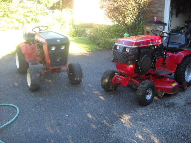

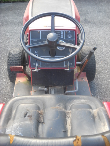

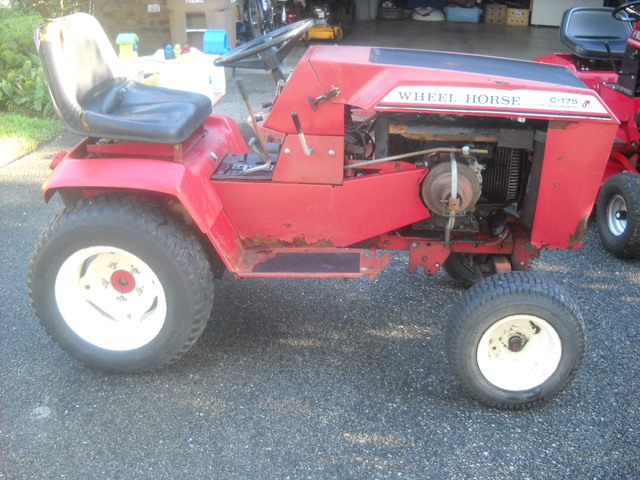

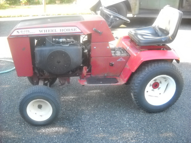

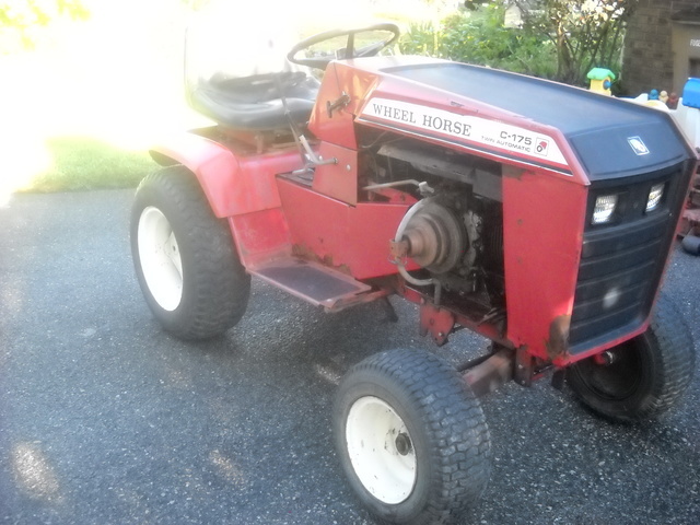

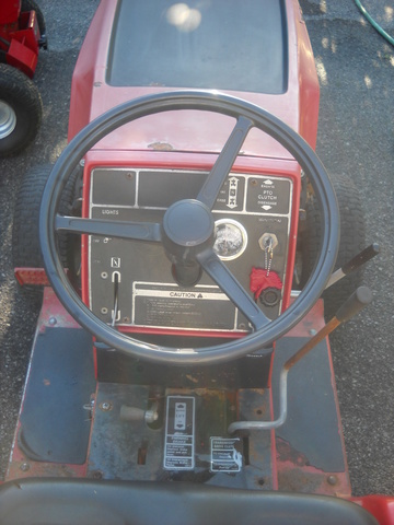

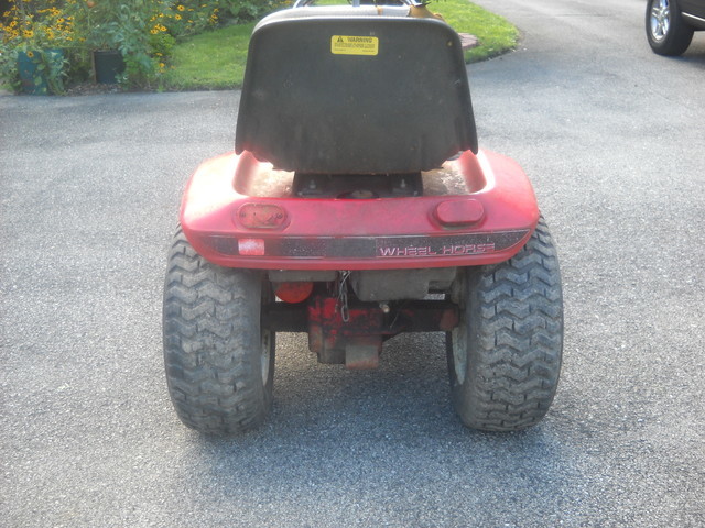

jdleach 525 #7 Posted August 21, 2016 Whenever I start a project, and after I have done an initial evaluation, I clean the beast. So, Phase I of C-175 resurrection has now been accomplished. Spent an hour or so scrubbing the tractor down and hosing it off. My philosophy has always been to get whatever machine I am working on, in as clean and presentable condition as possible. It is not near as nasty to work on, and it gives a sense of accomplishment out of the gate. Here is how the tractor looks now, sans mud, leaves, and a whole lot of greasy goo. Note in the photo of the dash, I have already begun the restoration: tractor now sports one of Glenn Pettit's key fobs. Was having so much fun, the 312 decided to join! 13 Share this post Link to post Share on other sites
Wheel-N-It 2,978 #8 Posted August 22, 2016 Good looking tractor. Very wise of you to give it a good cleaning first. It's no fun working on a nasty tractor that does not run. 2 Share this post Link to post Share on other sites
Pollack Pete 2,273 #9 Posted August 22, 2016 VERY nice C175.I've got a couple of them myself.Have fun with your new toy.PS Sure looks a whole lot better cleaned up. 2 Share this post Link to post Share on other sites
TDF5G 2,073 #10 Posted August 23, 2016 Congrats on your new acquisition! She looks very straight and solid and looks like it's going to be a worthwhile project. I notice the rear fender pan has already been upgraded from the original plastic to later model steel. I also like to clean things up before I start working on a project including the shop and floor! It just makes it more enjoyable to dig into! 2 Share this post Link to post Share on other sites
Wheel-N-It 2,978 #11 Posted August 24, 2016 Yes, the Blackhood tractors look much better with the steel rear fender pan. 3 Share this post Link to post Share on other sites
stratostar250 934 #12 Posted August 27, 2016 On the left side of the tractor, is that a lift indicator? That's pretty cool, I had a c-175 and mine didn't have one of those! 1 Share this post Link to post Share on other sites
jdleach 525 #13 Posted August 27, 2016 (edited) Yup, that is the lift indicator for whatever is attached. Have not posted for a few days, but I have not let the tractor languish either. Physically, I have done virtually nothing to the machine, other than to closely examine it. As I did so, I made an ever-growing list of items to purchase for the upcoming repairs and maintenance. Today, I plan to actually begin installing parts. The list of parts purchased thus far are: 1. Points and condenser. 2. Drive Belt. 3. Hydro cooling fan (blade broke to hell). 4. Plugs. 5. Air filter and pre-filter. 6. Hydro oil filter and oil. 7. Engine oil. 8. New tail lights (light lenses and housings all smashed, marker lights from NAPA are an almost exact match, although the single bulb models are no longer available, and the lens style is somewhat different). 9. Large bag of hair pin clips, machine screws, bolts, lock washers, etc., to replace the large variety of cotter pins, wire, nails, and missing fasteners on the tractor. As I did on my 312-8, the dash and tunnel panel screws are getting replaced with stainless steel fasteners of the same style. 10. Deck belt. Will post more, along with photos as the work progresses. Just now remembered some items I still need, and am heading out to get them. Edited August 27, 2016 by jdleach 2 Share this post Link to post Share on other sites
