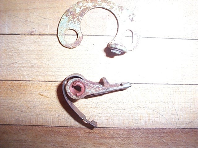

Pollack Pete 2,273 #8 Posted August 22, 2016 Squonk,here's a pic of the contact set I need.Couldn't find a distributor number ,at least with out removing distributor. Share this post Link to post Share on other sites

squonk 43,480 #10 Posted August 24, 2016 looks similar to that first one I listed. I'll look in my book but I don't have much faith. Share this post Link to post Share on other sites
squonk 43,480 #11 Posted August 24, 2016 This is the closest I could come up with: # CS251 They are a Renault points set but not quite the same. Sorry http://s7d9.scene7.com/s7/zoom/flasht_zoom.jsp?company=GenuinePartsCompany&sku=97923&config=GenuinePartsCompany/GPC-DBLCLK-ZOOM&locale=en&vc=image=GenuinePartsCompany/97923,GenuinePartsCompany/482830 Share this post Link to post Share on other sites
