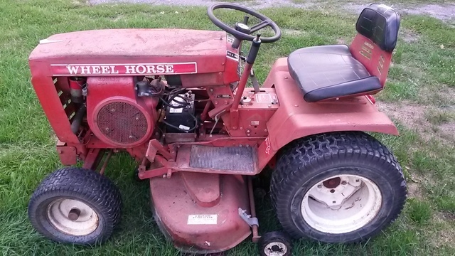

Got the carb cleaned up and it fired right up and purrs like a kitten.  It had not ran in five years according to previous owner.  Here are a couple of pics of it as well.  Rough looking but runs solid and transmission is smooth.

953 nut
:woohoo:             So satisfying!              :handgestures-thumbupright:
r356c
Another Sleeping Beauty that was ready to wake up from a long nap.:handgestures-thumbupright:

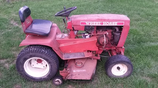

evanloock
Had a powered bagger at one time based on that belt guard.
Upper Canada
I was wondering about the belt guard....seemed a little different to me.  There is also a pulley near the back on the same side that is connected to the frame.  It can be seen when seat/fender pan is open.  Possibly from a tiller?
Racinbob
A tiller was the first thing that came to my mind. Something like the 7-1211. In 1974 the tillers used the one belt setup that went under the tractor eliminating the extended belt guard but it could be likely that someone mounted the older unit on it. I used a 7-1211 on my 76 but utilized the later single belt drive. It was much simpler to mount than the 2 belt drive. :)
