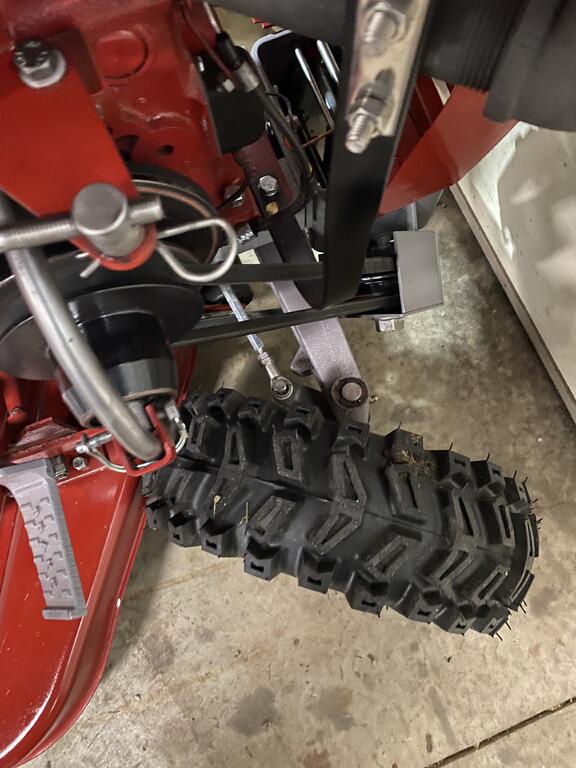

peter lena 9,562 #12 Posted May 21, 2023 @Heatingman REMOVE TRUNDLE , 3/8x 24 die nut go over original threads , use cutting oil , note last photo m battery ground bolt start point to engine cable / frame area , enhances , ELECTRICAL RECTIFIER GROUNDING , also note battery tender plug in on choke cable . got plastic washers for sloppy lever start area at h/w store pull out drawer section , silicone grease , solid , smooth . made my improvements to my 3 horses , pete Share this post Link to post Share on other sites
