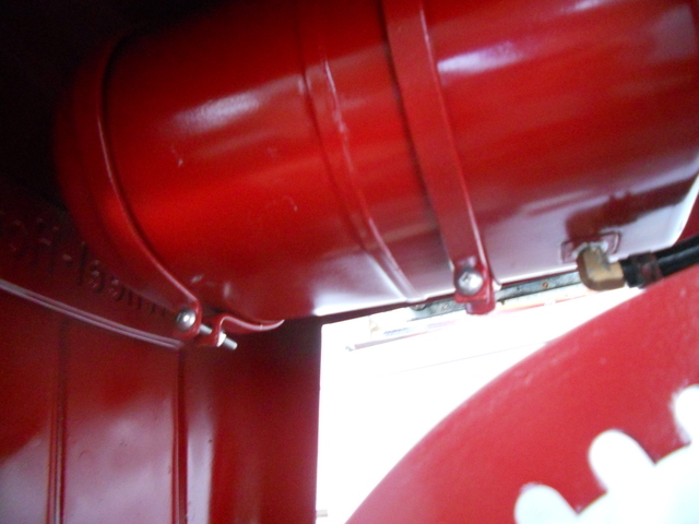

I think we are gonna need pics from you skeeter!.... I don't have any at the moment but there should be two straps spot welded to the boutom side of the hood just fore and aft of the filler hole. They do break off so we have seen them pop riveted back on. They join together with a machine screw & nut on the underside. Kinda hard to explain but I am sure someone will chime in with a pic

Here's what Jim is talking about. Usually the straps  are thinner but these are what was on mine. The thicker straps lowered the tank a bit so I extended the filler. :)
Search around here and you'll find some are fabricated to the frame so the hood doesn't bear the weight of a full tank.

Skeeters65
Ok thanks guys.
My hood doesn't have the straps in place. I guess I will be welding the straps back on.
