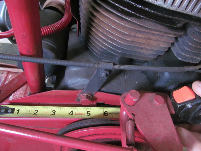

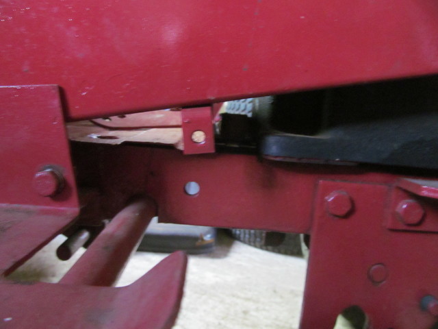

Ed Kennell 47,237 #2 Posted August 17, 2016 My belt had the same groove. Maybe these pics will help. There is a tab with a 1/4-20 tapped hole on the bottom of the guard....no idea what it was for as it doesn't match any holes in the frame. The bolt in the top tab also holds the cable support and a tab that is welded to the PTO lever support. 2 Share this post Link to post Share on other sites

RJR49 179 #4 Posted August 20, 2016 Ed that tab mates to a hole in the floor pan. In other words it's part of the floor pan mount. I found the missing part of my belt gard. It's a right angle bracket that also mounts to that tab. 1 Share this post Link to post Share on other sites

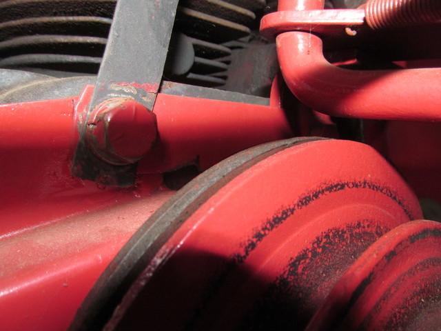

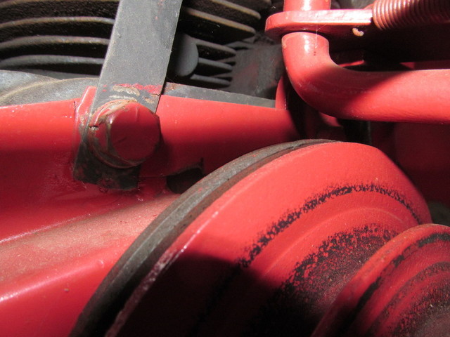

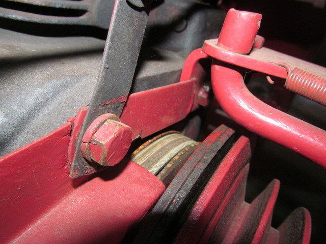

Ed Kennell 47,237 #5 Posted August 20, 2016 I'll have to keep my eyes open for that angle piece. On 8/17/2016 at 9:27 AM, Ed Kennell said: There is a tab with a 1/4-20 tapped hole on the bottom of the guard....no idea what it was for as it doesn't match any holes in the frame. Does the angle connect to the bolt shown in this pic? Share this post Link to post Share on other sites
