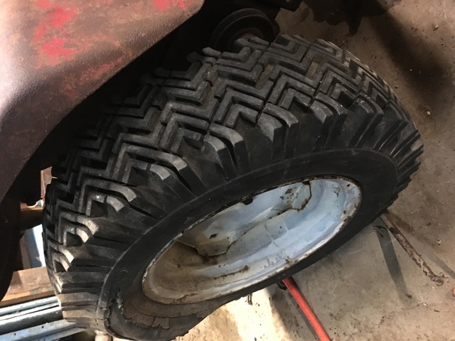

Team70R 157 #1 Posted August 16, 2016 Can anyone help me determine the size? Tractor year and model unknown. Tread width is 5" and over all height is 21" side wall says 2ply made in America Share this post Link to post Share on other sites
857 horse 2,588 #2 Posted August 16, 2016 (edited) 6-12....IS MY GUESS, some one come along soon and know more. Goi ahead and get them off,,,,get the wheels cleaned up....rims look great.!!!! More pics after or a pic or 2 of the wheel cleaning.... Speaking for the over 60 group...its easier to look at pics.....We all carry crayons in our pockets !!!! ... Edited August 16, 2016 by 857 horse BIG SHOW IS COMING SOON !!!!! June is just around the corner Share this post Link to post Share on other sites
wallfish 18,873 #3 Posted August 16, 2016 yup, tires are 6-12. Probably best to post a wanted ad on here for one or two used tires. Hold on to your shorts if you check the price on Epay for a new one of those. There were a couple different manufacturers for those so check the other one. General, Goodrich ect. Post some pics of your tractor if you want to know the model and year of it. Share this post Link to post Share on other sites

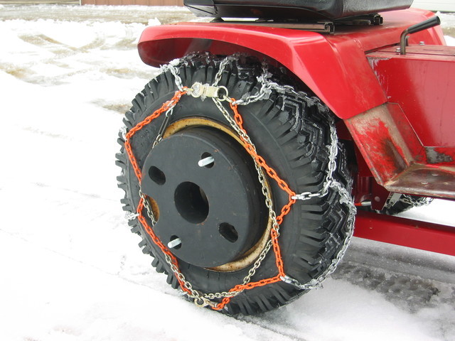

pfrederi 19,511 #4 Posted August 16, 2016 6.00 12s are great winter tires with chains. All my snow horses use them. Share this post Link to post Share on other sites
Team70R 157 #5 Posted August 16, 2016 thanks guys! I will post a pic tonight, still trying to determine the model. Has a 3 speed and a 6 horse Tecumseh with electric start. Definitely 60's Share this post Link to post Share on other sites
WHX?? 53,902 #6 Posted August 16, 2016 A few suppliers here but like John said hang on to yer shorts.... Miller tire has that tread pattern but hold them real tight http://www.millertire.com/categories/lawn-garden-tires/6-12/ maybe you can offset the cost by selling yer old ones to 'fish @wallfish for his horse scooter... Share this post Link to post Share on other sites
pfrederi 19,511 #7 Posted August 16, 2016 (edited) Years ago you used to see tire dealer ads in the paper for four tires mounted and balanced for $100, but with an asterisk. The price only applied to 155SR 12. (that is radial equivalent for 6.00x12) Bought 4 four for my 1981 Honda Civic cheapest tires i ever bought. Still have the tire chains for that size and they are on my winter horse. Edited August 16, 2016 by pfrederi 1 Share this post Link to post Share on other sites
wallfish 18,873 #8 Posted August 16, 2016 1 hour ago, WHX7 said: maybe you can offset the cost by selling yer old ones to 'fish @wallfish for his horse scooter. Ha, real funny Jim, but I still need those rounded diamond treads from you for my horse scooter. No more square tires! 1 Share this post Link to post Share on other sites
Team70R 157 #9 Posted August 17, 2016 I will probably go with the carlisles. Gonna be tilling with it! Found some for a decent price Share this post Link to post Share on other sites
