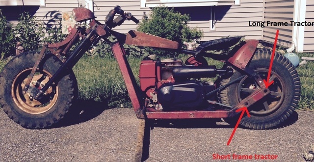

wallfish
Here's a pic of a snow plow frame
Notice the holes for changing the mounting bar for short frame and long frame tractors.
Nothing wrong with a little fabrication on them either! :lol:
