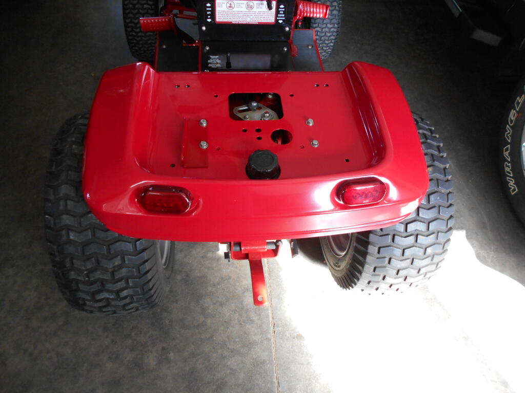

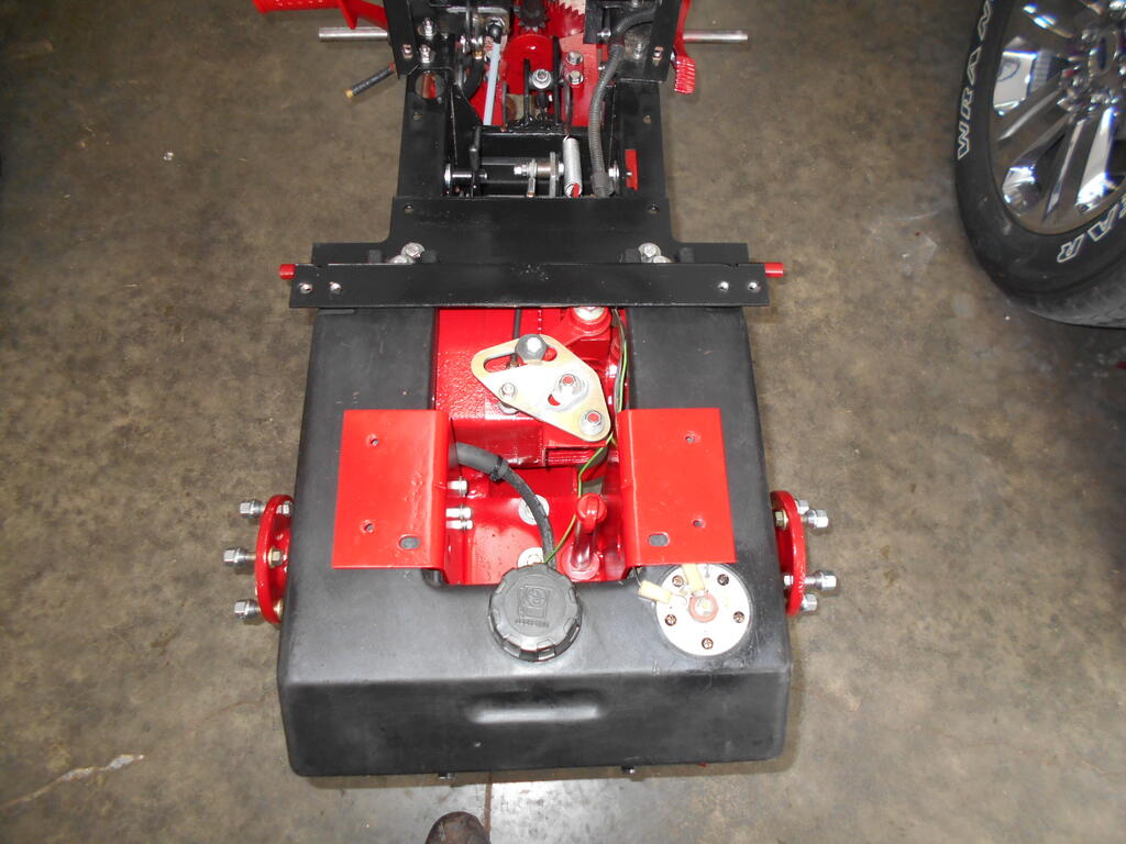

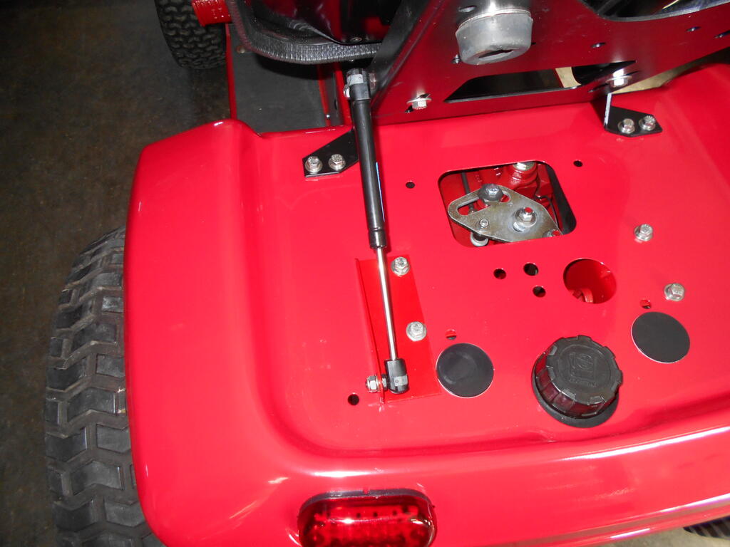

cleat 8,103 #6 Posted October 30, 2024 (edited) Here is a picture showing all 8 bolts that must be removed. Disconnect the lift shock then pull the 4 bolts holding the seat pivot brackets near the front of the fender and lift off the seat assembly. Now just remove the 4 bolts left holding the fender then lift it off.Note: you will likely need to unplug the taillight wires as you lift the fender up so it will come off. You can see the fuel sending unit near the back right hand side. Make sure both wires are plugged in. Preferably, the black wire goes to the connector on the body of the sending unit and the brown wire goes to the connector in the center of the sending unit. Then just reverse the disassembly instructions to put the tractor back together. Edited October 30, 2024 by cleat 1 1 Share this post Link to post Share on other sites
