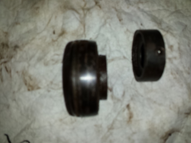

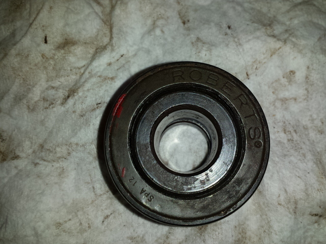

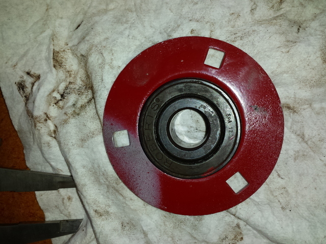

moe1965 774 #1 Posted August 15, 2016 I'm having a hard time finding these bearings. Anyone know where I can purchase some. 2 in od. 3/4 id. They are for a st 326. Snow blower. Share this post Link to post Share on other sites

moe1965 774 #15 Posted August 19, 2016 On 8/15/2016 at 6:37 PM, WNYPCRepair said: Do you have a Toro part number for those? The ones I bought were 110569. $18 each from an ebay buyer weldenhardware. It appears they no longer have any. If they are the same as the Toro 110569, I will buy some of them from you. They are $50 and up everywhere I see them The part number is not a toro part number but here is what I came up with. Peer is the manufacturer of the bering. Fhs205-12 Share this post Link to post Share on other sites
WNYPCRepair 1,924 #16 Posted August 19, 2016 They appear to be different than the ones for the 2 stage Share this post Link to post Share on other sites

Kurt-NEPA 756 #18 Posted August 19, 2016 I'm not sure this is right, but try a SA204-12 bearing. It fits a 3/4" shaft - cam lock and spherical mount. 1.85" OD. My single stage uses the 7/8" ID version of this on the jack shaft. http://www.usabearingsandbelts.com/m7/SA204-12--3-4-spherical-insert-bearing-with-locking-collar-sa204-12.html Sometimes I can get this series of bearings and flanges at TSC. Share this post Link to post Share on other sites
