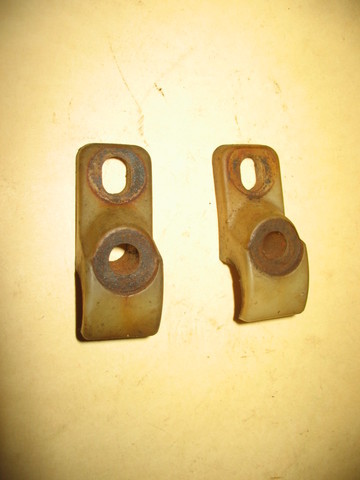

lfhcb 0 #1 Posted August 15, 2016 Can any one tell me where I buy the nylon parts that hold the rear wheels to the mower deck. I believe this is a 1973 or 1972 it is Tecumseh powered instead of Koller. thanks in advance lee Share this post Link to post Share on other sites

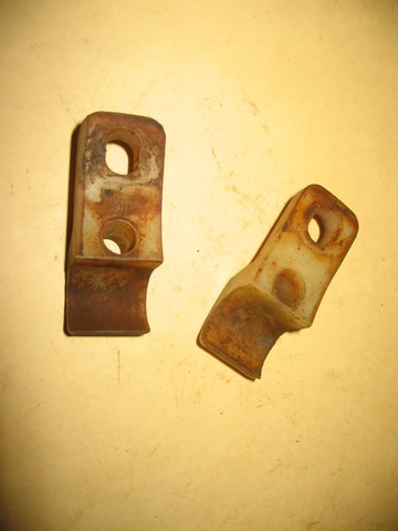

daveoman1966 3,881 #2 Posted August 15, 2016 Me thinks you are after the nylon parts # 6724...typical of older mower decks. I have a pair of them and they are cracked...not broken, just cracked. Here is a pic or two . The crack is on the thinner lower mounting hole...not the really thick one in the center. Use a thjck washer when mounting and they should be ok $25....shipped to USA zips. Share this post Link to post Share on other sites
