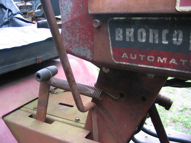

daveoman1966 3,882 #3 Posted August 14, 2016 I had the same issue with my Bronco 14 and hooked up an external spring...see pic. I know that the Chg 12 lever is a bit different, but you MAY be able to do something like this. 1 Share this post Link to post Share on other sites
