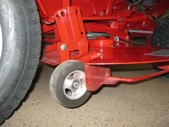

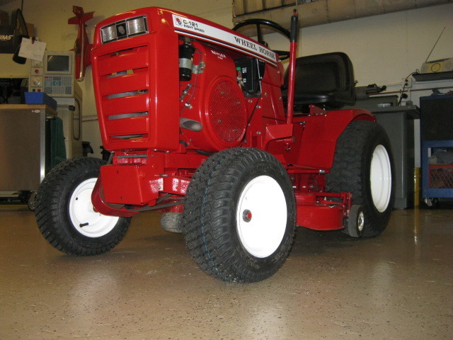

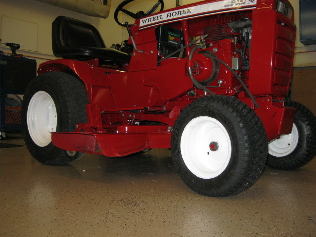

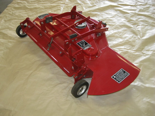

Dayton Murdock 127 #26 Posted August 27, 2016 Got the belt today I overhauled the deck with new spindle bearings , pulleys and had it powder coated to match the Tractor 8 Share this post Link to post Share on other sites
Texas Todd 1,026 #27 Posted August 27, 2016 (edited) I would be curious to know the rough cost of powedercoating. No doubt it's more durable.... Looks awesome! Edited August 27, 2016 by HD-Horse Share this post Link to post Share on other sites
rjg854 13,311 #28 Posted August 27, 2016 A truly fine job! I'm sure you're pleased with the outcome. Share this post Link to post Share on other sites

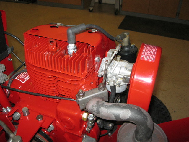

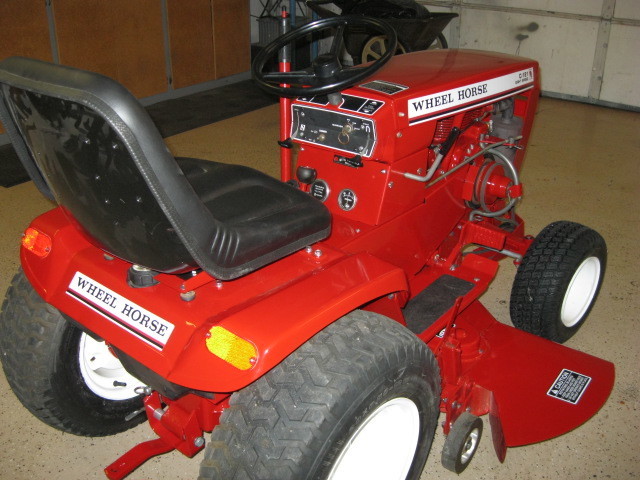

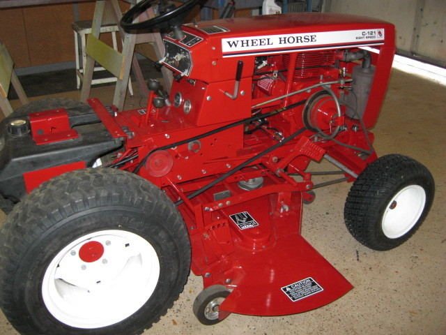

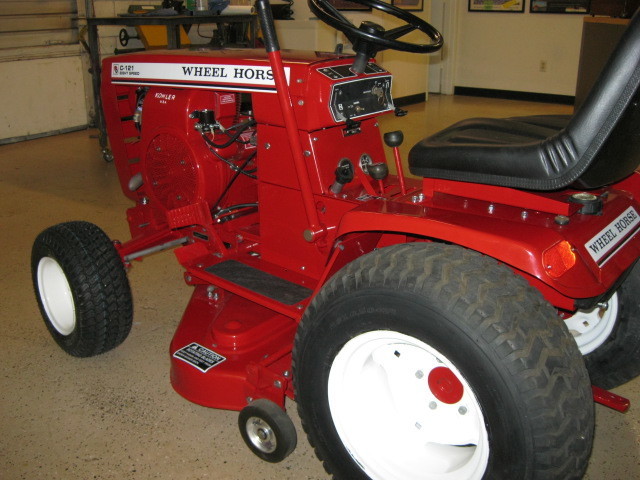

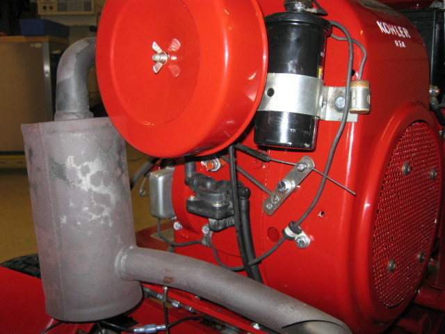

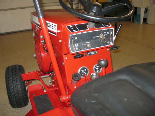

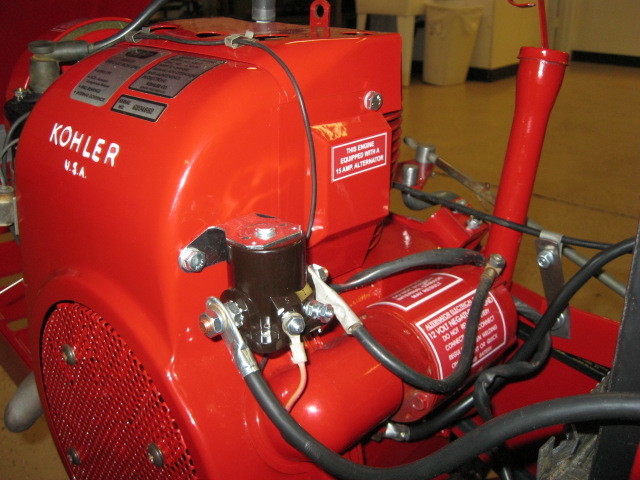

Dayton Murdock 127 #29 Posted August 31, 2016 Hi All I am almost done with this project there are a few details left. I just order the PTO knob and new throttle and choke handles and I need to figure out how to clamp the end of my throttle cable correctly. The engine started well but the governor is running at to high of RPMs maybe just a adjustment?. Here are the latest Pics. 12 2 Share this post Link to post Share on other sites
rjg854 13,311 #30 Posted August 31, 2016 Just a fantastic job Share this post Link to post Share on other sites
608KEB 843 #31 Posted September 6, 2016 Looks awesome. Where'd you purchase the mower deck wheels from? Share this post Link to post Share on other sites
Dayton Murdock 127 #32 Posted September 6, 2016 My deck wheels are a product that my company produces for the experimental aircraft market 2 Share this post Link to post Share on other sites
Matt Young 63 #33 Posted September 6, 2016 I would love to get a set of those wheels for the deck Share this post Link to post Share on other sites

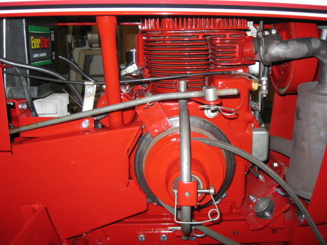

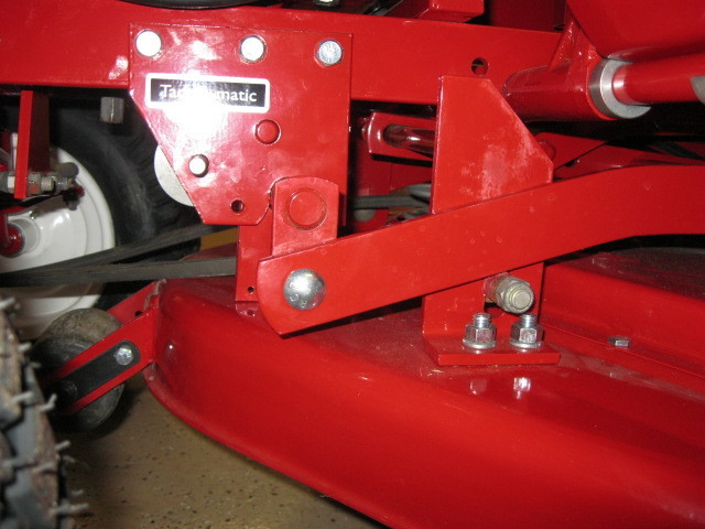

953 nut 68,529 #34 Posted September 6, 2016 (edited) On 8/26/2016 at 7:35 AM, Dayton Murdock said: garden tractor free zone in America. I have never been to Carson City, but other parts of Nevada I have been to had no grass, little wonder there is a shortage of supply. You are doing a great job. One thing I noticed is the mower drive belt should be moved to the inner grove of the PTO. Edited September 6, 2016 by 953 nut Share this post Link to post Share on other sites
Dayton Murdock 127 #35 Posted September 7, 2016 Hi All I installed a NAPA 5L820 Vee Belt on my tractor and it slaps how do I prevent this from happening, is there a difference in drive belt design that would cause this to occur? Share this post Link to post Share on other sites
Dayton Murdock 127 #36 Posted September 19, 2016 Hi All I installed my new 7374 belt yesterday with outstanding results. My new belt was delivered in a bag instead of a cardboard sleeve. I believe that the sleeve will cause the belt to take a set in the location of the radius and then transmit a slap to the guards of my Tractor. In the future I will try to buy belts ina bag Share this post Link to post Share on other sites

TimC121 0 #42 Posted July 11, 2019 did you ever find photos of correct routing of the fuel line? mine hangs on the outside of the frame and gets into the way of the clutch pedal linkage. using your photos to help fix and restore my 79 c121 8 speed. Share this post Link to post Share on other sites
