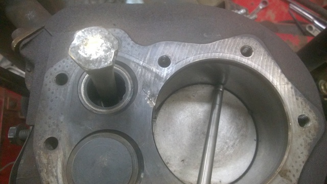

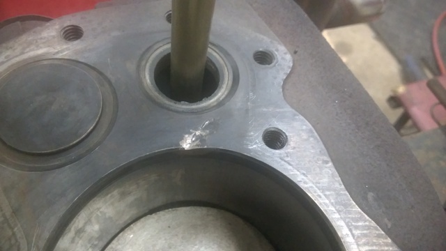

oe espo 32 #1 Posted August 3, 2016 (edited) Well I had a machine shop make me a valve guide removal, installation tool. My first mistake! 2nd was to start working on it after a bad day of work. Some opinions please if I destroyed this block??? There was a crack at the top of bore I tried to blend out with did grinder. I'm very upset. I waited months for my carb to get rebuilt, now this. Thanks Edited August 3, 2016 by oe espo typo Share this post Link to post Share on other sites
JAinVA 4,638 #2 Posted August 3, 2016 (edited) For the cost of a good used block,I doubt I'd trust putting money into one cracked where that one is.If you decide to replace the block Joe's Outdoor Power in Michigan is a good source for a used block.JMHO,JAinVA Edited August 3, 2016 by JAinVA Share this post Link to post Share on other sites
Achto 30,210 #3 Posted August 3, 2016 I would not continue with that block either. Share this post Link to post Share on other sites

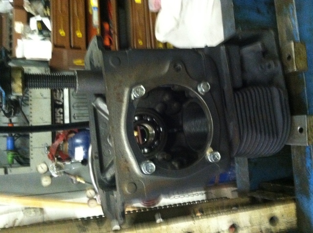

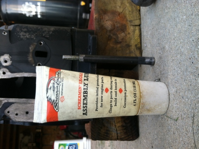

Hossenfeffa 49 #5 Posted August 3, 2016 (edited) The valve guides can be removed by pressing them out of the block from the crankcase side using a valve guide removal/ driver tool. You have to shim one side of the block to compensate for the 4 degree valve angle. I just did mine this way. The exhaust guide can be very stubborn to remove, and I can't see the other removal methods working very well. For installing the new guides I heated the block to 275 degrees using an electric hot plate, put the giudes in the freezer for a couple of hours beforehand Used the same tool to install the guides, however used the swinging press ( big hammer) for installing them. I have a used block if your interested needs to be bored .020. Press set up. Valve guide remover/ installer Edited August 4, 2016 by Hossenfeffa 1 Share this post Link to post Share on other sites

Hossenfeffa 49 #10 Posted August 4, 2016 I guess I am fortunate that I kept the tools needed to do this when I sold my motorcycle repair business. Sorry, took those pictures with my phone, can't figure out how to rotate them to show correctly on the forum Share this post Link to post Share on other sites
Fordiesel69 271 #11 Posted August 4, 2016 The piston already has carbon ridge erosion so its a well worn engine. Although I would not put a ton of money into it with that dent, there is no reason you can't smooth that out more with a grinder and keep on running it. That area is pretty thick. 1 Share this post Link to post Share on other sites
JAinVA 4,638 #12 Posted August 5, 2016 (edited) The issue with the crack is how deep does it go.You may grind it down to where you don't see any remnant but it may be microscopic.Heat the block,to running temps and the head gasket won't seal no matter how much JB weld you fill it with.Get a different block.In my opinion it is not worth messing with what you have.JAinVA Edited August 5, 2016 by JAinVA 1 Share this post Link to post Share on other sites
Fordiesel69 271 #13 Posted August 6, 2016 Look at the crack. The head gasket does not seal there. Its not a crack anyways, zoom in and look! Share this post Link to post Share on other sites
