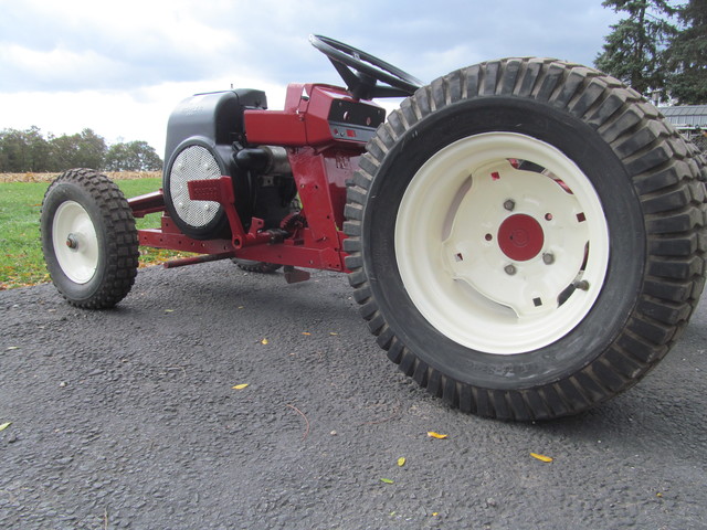

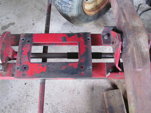

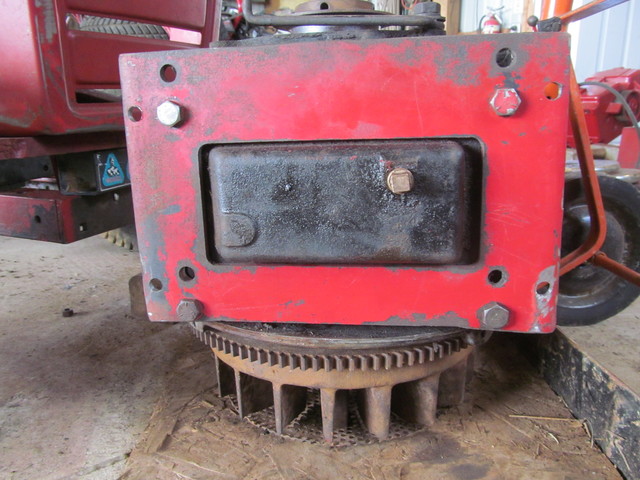

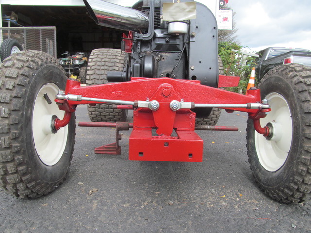

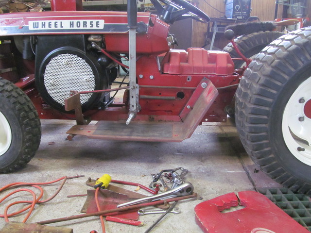

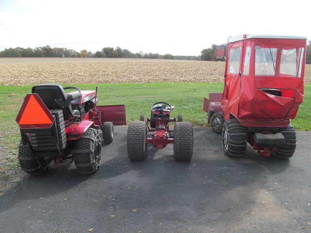

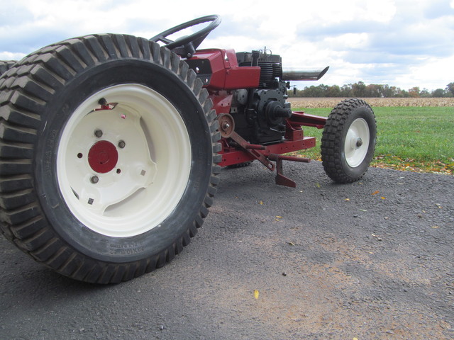

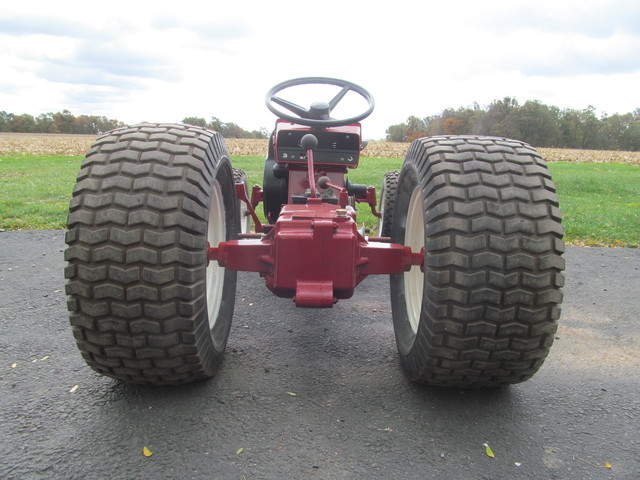

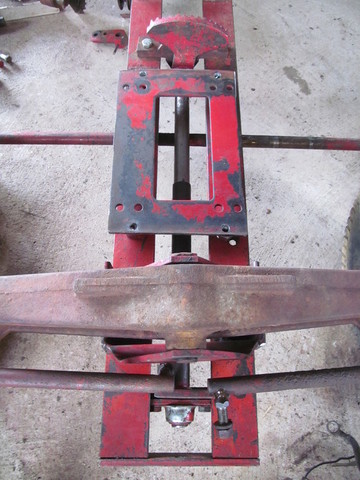

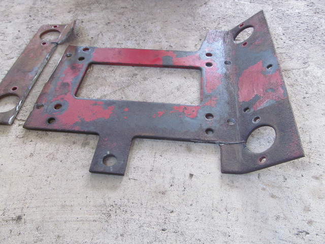

Ed Kennell 46,662 #37 Posted October 25, 2016 (edited) Well, I made enough progress to warrant a few pic. I cut the bends off the 105 rocker plate to make a solid engine mounting plate for the 321. I had to shim the plate up 1/2" to get the dropped pan to clear the steering rod extension tube. Got the steering geometry worked out and the engine installed. And got some painting finished. Still have to work out the clutch and throttle linkage. and a lot of body work on the hood and seat/fender pan. Got the snow movers ready and snapped a pic for size reference. Edited October 25, 2016 by Ed Kennell 13 Share this post Link to post Share on other sites

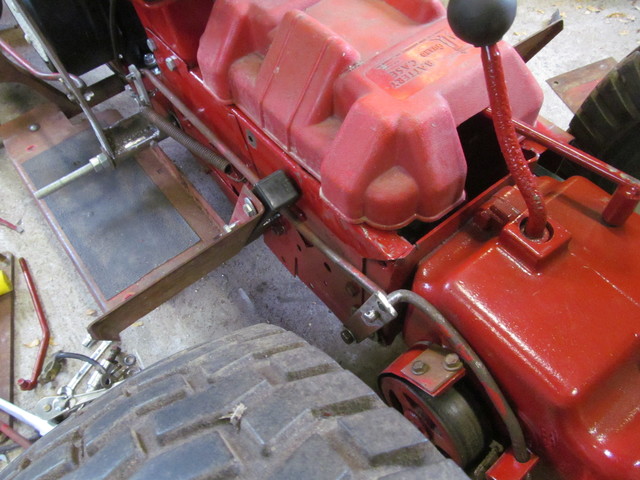

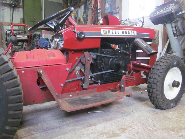

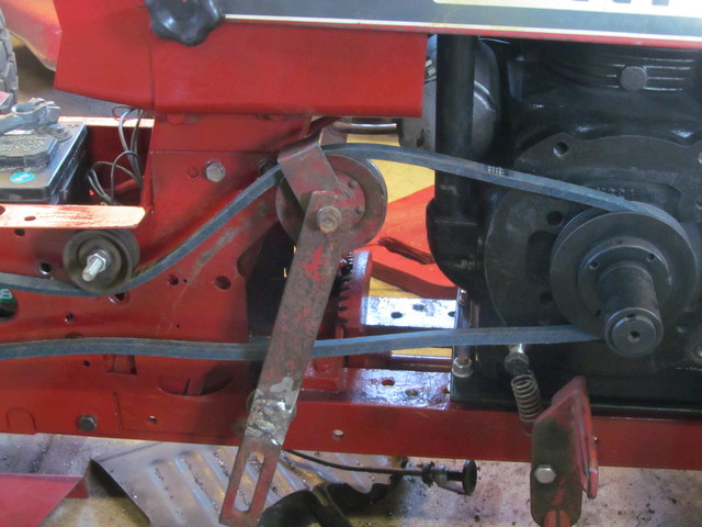

Ed Kennell 46,662 #42 Posted November 17, 2016 Some progress on the clutch assembly. I wanted hand and foot control. Still need to tie the brake into the clutch linkage. Had to add a second idler to make it work in the confined space. Next is the belt guard and foot pedal throttle linkage. 9 Share this post Link to post Share on other sites

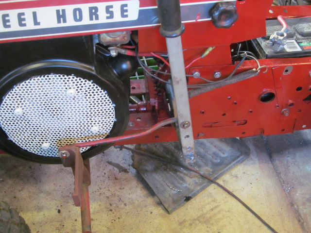

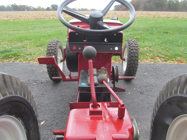

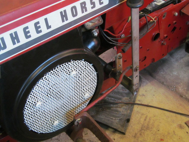

Ed Kennell 46,662 #48 Posted November 25, 2016 Got the throttle, clutch, and brake linkage worked out. Took a short test run. Everything worked, but I was running gravity fuel feed (no fuel pump) to the carb and the 321 was running out of fuel at WOT. So a $9.48 electric JUNGLE pump is coming on Tue. Now for the body work. 11 Share this post Link to post Share on other sites
