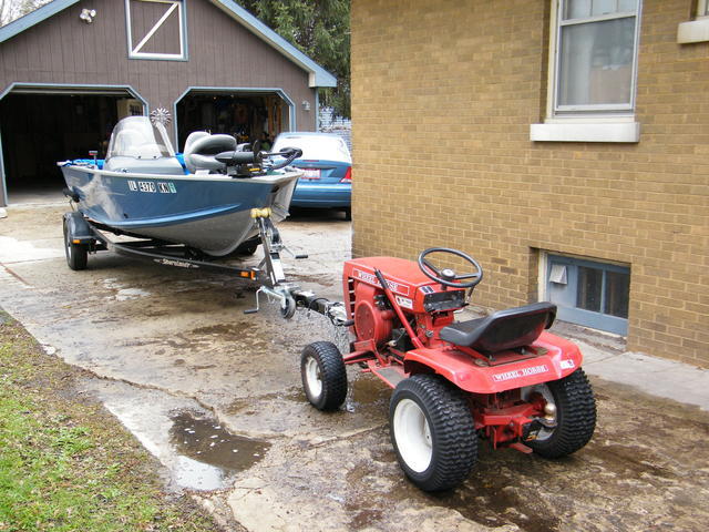

Retired Wrencher 6,466 #3 Posted July 30, 2016 I used to tow my 20` boat out of the Garage with a 1057. I have a picture some where.. And my first introduction to Wheel Horse [ early 80`s} was a boat dealer that I did business with early 60 vintage model. He used to move large boats around on the show room floor. I believe they where smaller cruisers 20` and above. Boy could you snake in a trailer with a tractor. Nice tight fit. that is my . 3 Share this post Link to post Share on other sites

Uncle Buck 246 #7 Posted July 30, 2016 4 hours ago, T1257 RETIRED WRENCHER. said: I used to tow my 20` boat out of the Garage with a 1057. I have a picture some where.. And my first introduction to Wheel Horse [ early 80`s} was a boat dealer that I did business with early 60 vintage model. He used to move large boats around on the show room floor. I believe they where smaller cruisers 20` and above. Boy could you snake in a trailer with a tractor. Nice tight fit. that is my . Exactly, I use to do the same thing myself using nothing more than a 1968 Lawn Ranger. In fact, once I chained a Chevy 350 engine complete with heads and internals laying on the ground to the same LR and drug it across the yard to my engine hoist. That was dead weight too, not rolling weight. 3 Share this post Link to post Share on other sites

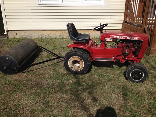

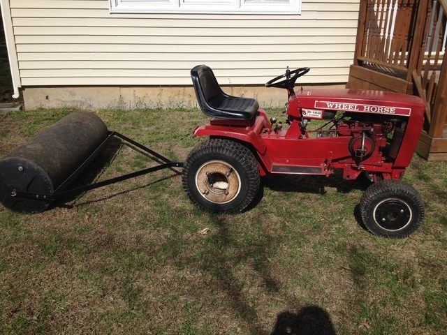

TDF5G 2,073 #17 Posted August 1, 2016 300 LBS should not be a problem for your horse. I pull a 48" lawn roller full of water which is supposed to be 540 lbs, with my B-100 which pulls it up hills with no problem. And that's also with about 100 lbs or so of wheel weights attached. 2 Share this post Link to post Share on other sites
