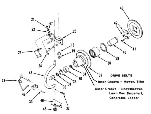

osubrutus1 3 #1 Posted July 21, 2016 my c-175 with 42" mower deck chews up a belt a year, the one from motor to deck, it will twist it the snap it. what am I doing wrong? Share this post Link to post Share on other sites
scotty 252 #2 Posted July 21, 2016 Im not sure if this has anything to do with it eating belts but do you have it on the right pulley groove? 1 Share this post Link to post Share on other sites
daveoman1966 3,880 #3 Posted July 21, 2016 After-market belts will do that...disintegrate is a short time. Primarily because the geometry of the V belt is not IDENTICAL to the OEM belt. The cheapy belt will not mate EXACTLY to the contour or shape of the Wheelhorse V pulley(s) and will either roll over or ride too low or too high in the V of pu7lleys. Use OEM belt and I bet your problem will go away....unless you have a bad pulley or bearing along the way. 2 Share this post Link to post Share on other sites
