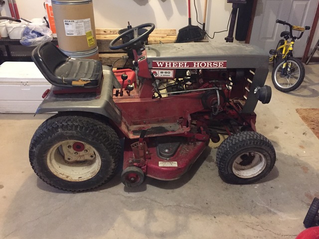

KC9KAS 4,744 #3 Posted July 18, 2016 @Timr82 and please post pictures of your tractor! Share this post Link to post Share on other sites

Timr82 1 #5 Posted July 19, 2016 my first wheel horse had for about 3 years but hasn't ran for the last 2 just got the motor rebuilt 3 days ago and is my first rebuild ever plan on tearing down and painting this winter. 1 Share this post Link to post Share on other sites
