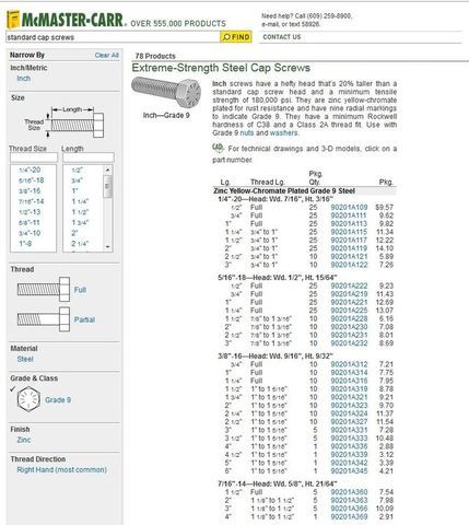

DennisThornton 4,772 #9 Posted July 31, 2016 Two new to me pieces of info this morning: " weak point from the auto 18 through the 1976 models." and "grade 9" bolts! I manage a hardware store and I've never heard of "grade 9"! I will have to keep an eye out! So only the "Automatic18"s and Ds up to 76 have this issue and the parking brake should never be used? Later models were improved? Share this post Link to post Share on other sites
pfrederi 19,511 #10 Posted July 31, 2016 Grade 9 is what I put in my D200 1 Share this post Link to post Share on other sites
"D"- Man 827 #11 Posted July 31, 2016 On 7/18/2016 at 11:15 PM, 23 Automatic LSE said: Ken, keep in mind the ring gear {part#101622} and the two end caps {part #101621} that were on the 18 Automatics which used the 5/16" bolts, probably should not be bored oversized to accommodate 3/8" bolts; but, rather replaced with part #'s 105060 and 105061 as these were a little beefier in these areas. One other benefit to the 3/8" parts, is the larger openings in the end caps, perhaps for greater lubrication to the pinion gears. P.S. I am not saying it could not be done, I personally would not do it,: but, as you know my set up is for duals. Thought I would do a side by side of the end cap from an 18 Automatic (top) to an end cap from a D-180 (bottom) to illustrate the difference in the size of the openings for lubrication of the pinion/axle gears. Please notice the "U" shaped cut-outs at 12:00, 3:00, 6:00 and 9:00 o-clock on the end cap in the lowest picture vs the little round holes in the top end cap at 3:00, 6:00 and 9:00 o-clock. P.S. You may have to click on the image in order to enlarge. Share this post Link to post Share on other sites
Factory Dog 44 #12 Posted July 31, 2016 Thanks for the pictures! I have never seen the later assembly. I found some information on the shear rating for grade 8 bolts. It appears that the 5/16 has a shear rating of around 6,980 lbs. while the 3/8 is rated around 10,050 lbs., which is a very significant difference. I am not sure what the grade 9s are rated at? The bolts I removed from the ring gear assembly showed extensive wear. The 3/8 bolts would provide a much greater wear surface along with the increased strength. I am going to be very busy for the next couple of months, but I will try to make some calls and see what I can round up. Thanks again for everyone's input! 1 Share this post Link to post Share on other sites
