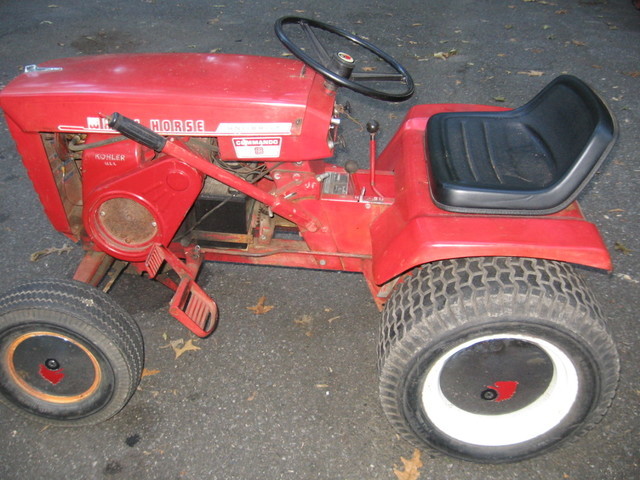

Buzz 502 #1 Posted July 18, 2016 A friend has two Commando 8s with the same model number, 1-4831. One is the normal 4 speed, the other is an 8 speed. The book says they were all 4 speeds has anyone else seen this model with the 8 speed? Here are some pictures. 8 Share this post Link to post Share on other sites

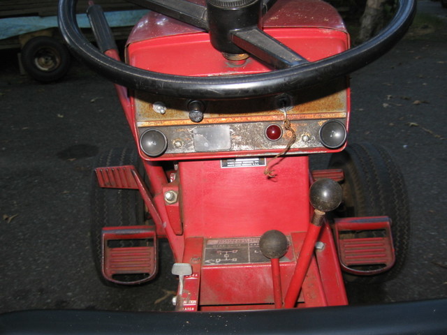

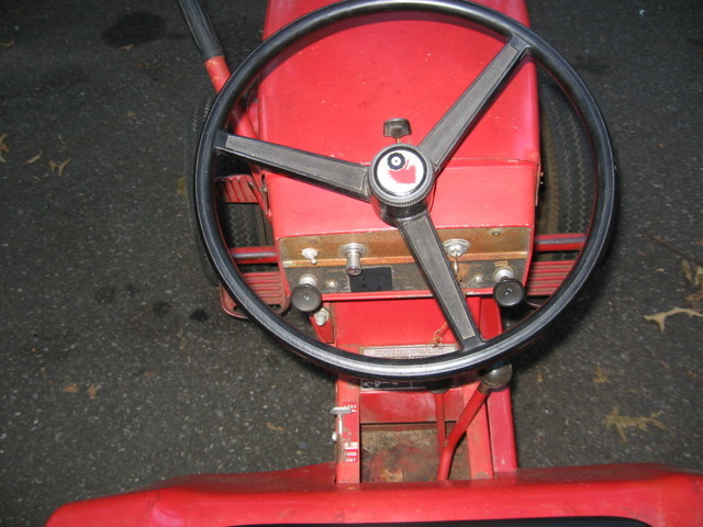

Sparky-(Admin) 24,646 #3 Posted July 18, 2016 I agree with Craig...someone has probably done a tranny swap. What does the decal say that is covered (in the pics) behind the hi/low shifter? Mike......... 3 Share this post Link to post Share on other sites
Wheel-N-It 2,978 #4 Posted July 18, 2016 1 hour ago, AMC RULES said: I'm betting... the original rear was swapped out at some point. Is there a sticker by the Hi/Low range selector that shows two ranges from the factory? 1 Share this post Link to post Share on other sites

KC9KAS 4,746 #6 Posted July 18, 2016 Looks like the shift pattern has the HI/LOW decal on the 8 speed. Looks like it had the tranny swap as well as the shift pattern plate. OR Wheel Horse just made a 8 speed out of this one. We all know that just as soon as we think we know everything to know about a model someone finds an exception! 2 Share this post Link to post Share on other sites
MalMac 1,334 #7 Posted July 18, 2016 (edited) If you do a tranny swap you have to change the shifter plate because a 3 speed plate is too big, the plate like what's on a 867 is shorter to allow room for the Hi-lo shifter. Edited July 18, 2016 by MalMac 3 Share this post Link to post Share on other sites

JimD 3,347 #14 Posted July 18, 2016 In pics 2 and 3 the paint looks darker and shinier on the shifter decal plate than on the dash tower right in front of it. Just my opinion. 2 Share this post Link to post Share on other sites
stevasaurus 23,619 #15 Posted July 18, 2016 MalMac...that is the next place to go. The transmission that came with the 1-4831 would be a 3 speed #5053. The #5053 would have the brake drum on the mushroom gear shaft (the hole closest to the axle housing...thus a 6 speed should bolt right in with no linkage changes. If it is factory...it would have a 6 speed. If the brake drum on Buzz's horse is on the cluster gear shaft (the next hole toward the front) it is an 8 speed and no way that is factory. Another question...would a dealer change out the trans for a costumer when he ordered the horse?? I think they would...why not?? 2 Share this post Link to post Share on other sites
