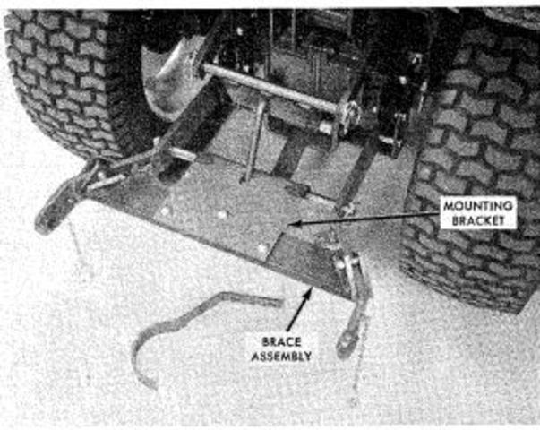

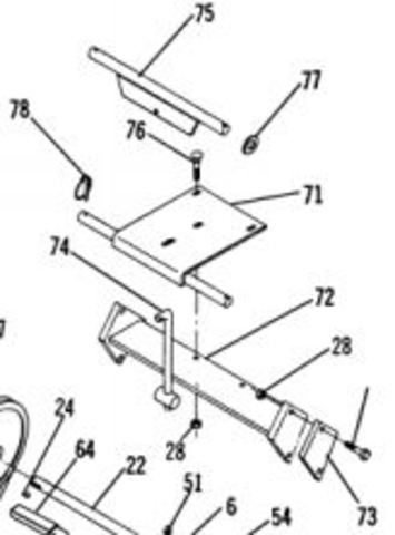

Aldon 4,830 #1 Posted July 14, 2016 I need the bracket assy that attached to the GT14 3 point hitch to support the tiller 7-1232. I have posted a want ad in classifieds for a bracket assembly but I assuming I do not locate an assembly I will end up fabricating one up. To that end, If anyone has one that can take measurements and perhaps a couple photos that would be an immense help and greatly appreciated. I pulled these pics from the manual. Share this post Link to post Share on other sites

DTOM 124 #8 Posted September 26, 2016 I found items #72 & #73 so far. That bar is 3/4" thick!!! 2 Share this post Link to post Share on other sites
Aldon 4,830 #9 Posted September 26, 2016 2 minutes ago, DTOM said: I found items #72 & #73 so far. That bar is 3/4" thick!!! That is really good news. I've been looking and have people similarly looking around the country. If I can get the measurements I can have a shop fabricate a set or two up for my two tractors. That bracket set up has been really challenging to locate. 1 Share this post Link to post Share on other sites
DTOM 124 #10 Posted September 27, 2016 Sure thing on the measurements. Contact me tomorrow at (860)930-3354 Jason. I can verbalize it to you in more detail. This goes for anyone else that is interested also. .75" thick x2.5" flat stock. 19.25" long end & 15" short end on center. 2 end plates at 2.75"x2.75"x.375" That is your materials i can explain the rest on the phone. If your coming to Stevebo's next month i can fab one up for you? 2 Share this post Link to post Share on other sites
