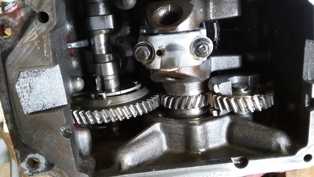

Well it's back from the land of the dead. I posted  this last month about the knock after i
put my 48" deck on it and got about 100 feet and it started knocking. I got a lot of help about
checking rod and crank for out of round or ware from Rmaynard,Spinjim,Malmac,Ken B,Shynon
WH nut,bds1984,Can Whlvr,Buckshot1 and TT .Thanks guys for your help.
I did check those and every thing was good as far as in specifications.
Every thing looked good but after i found the front balance gear
snap ring comming off i checked the pictures i posted and low and behold there it was in the
picture. i tryed to reinstall the snap ring but it was too sloppy,i tryed to bend it closed but when i
spred to put it on post it was to sloppy. So i bought new snap rings for both balance gears and replaced them. Now it sounds like it should.this engine has been rebuilt before i got it.Sorry TT i just couldn't
brake the rear balance gear as you posted, This engine runs to good. I just wanted to repost this
for those of us that don't know enough about these engines.If i would have found the balance gears
sloppy i would have taken them out. I had a feeling that it didn't sound like a rod knock,But i didn't
know a balance gear would make that kind of noise either.
Picture #1 shows the balance gear snap ring half way off ,Picture BEFORE and AFTER are
self-evident . my only advice is if you have balance gears and want to keep them replace the
snap rings if you ever open the engine .
