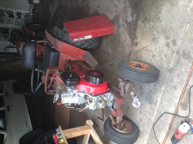

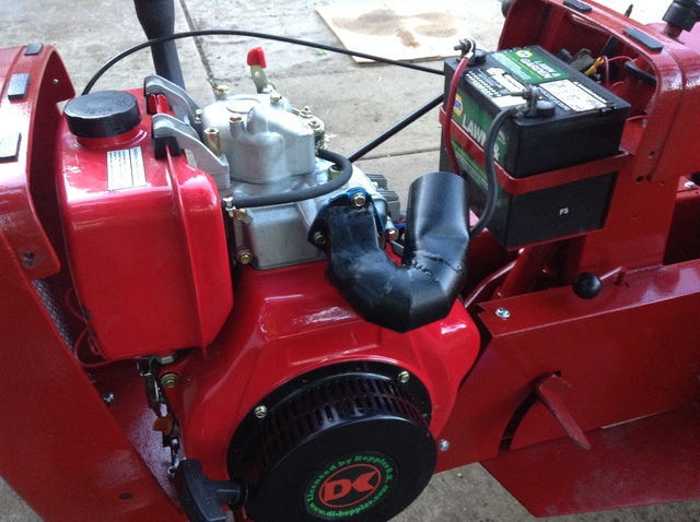

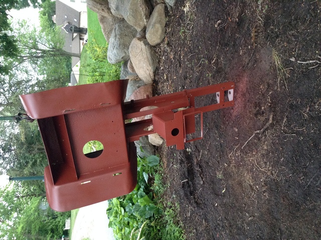

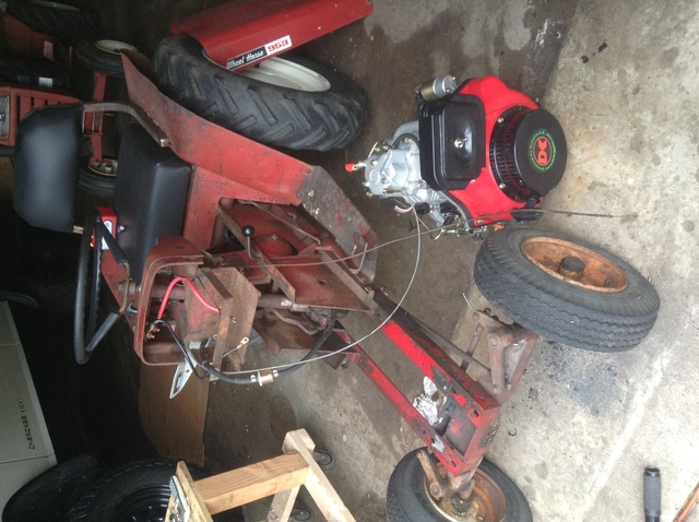

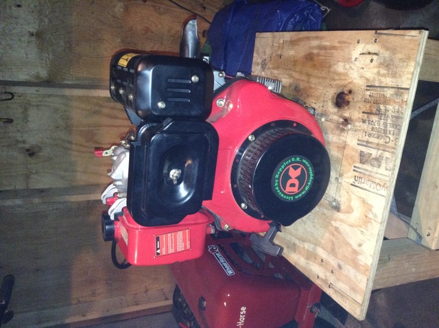

JamesC-120 204 #1 Posted June 30, 2016 (edited) I bought a 953 a few months ago and I got a killer deal on a 10hp Chinese diesel. So I decided to swap in the diesel since the old 10 horse was getting tired. I started this project about 3 weeks ago and have most things ready to be put together but not everything is painted. I also did a 8 pinion swap in the trans. I have taken many pictures through out. One of my questions is my hydraulic cylinder and my pump both leak badly. Is there anywhere to get new seals? Edited June 30, 2016 by JamesC-120 7 Share this post Link to post Share on other sites

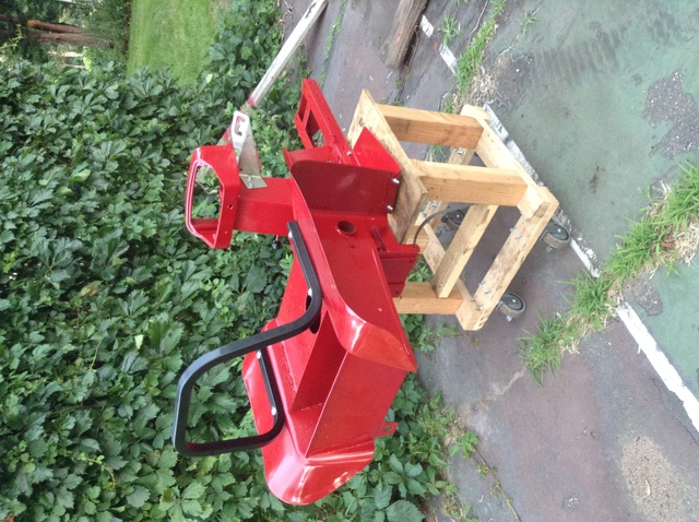

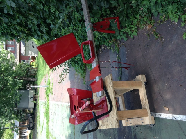

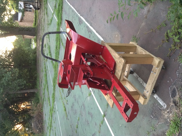

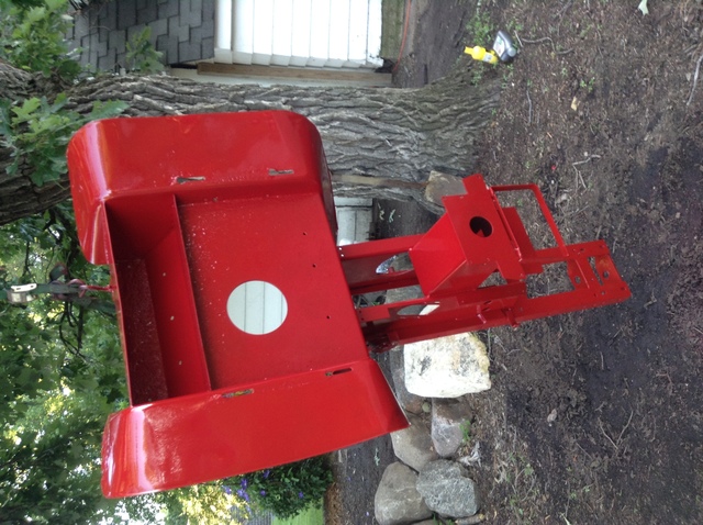

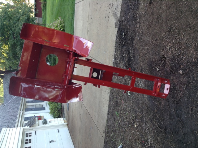

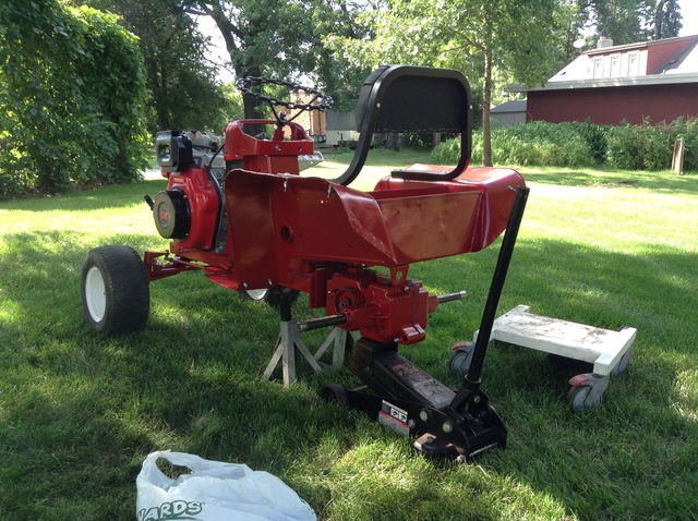

prondzy 3,889 #7 Posted June 30, 2016 (edited) Looking good James! What are you using to hold the frame up for painting? Edited June 30, 2016 by prondzy Share this post Link to post Share on other sites

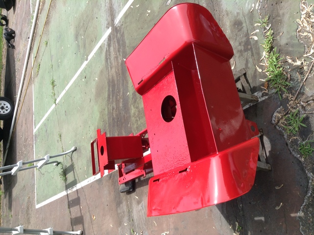

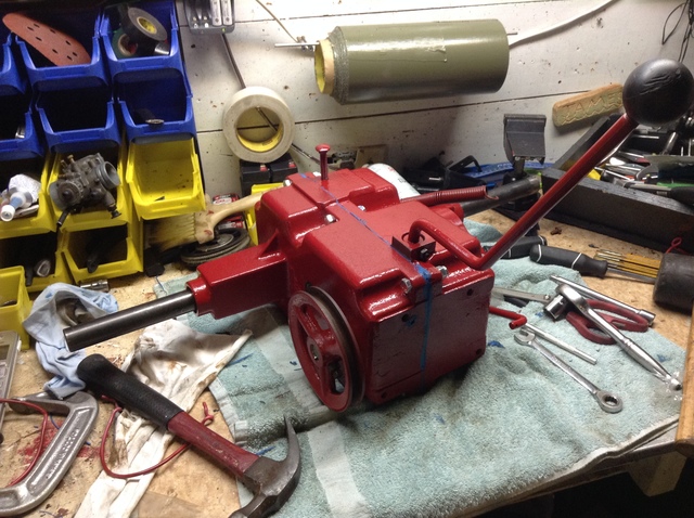

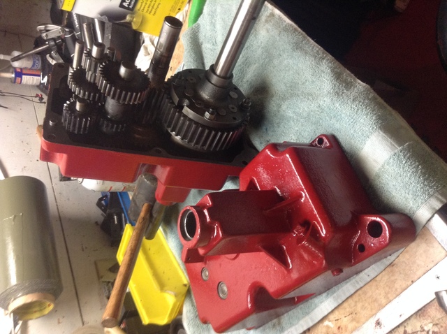

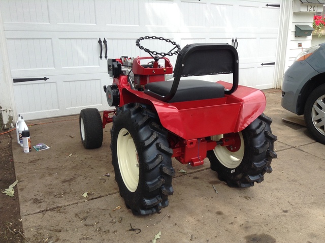

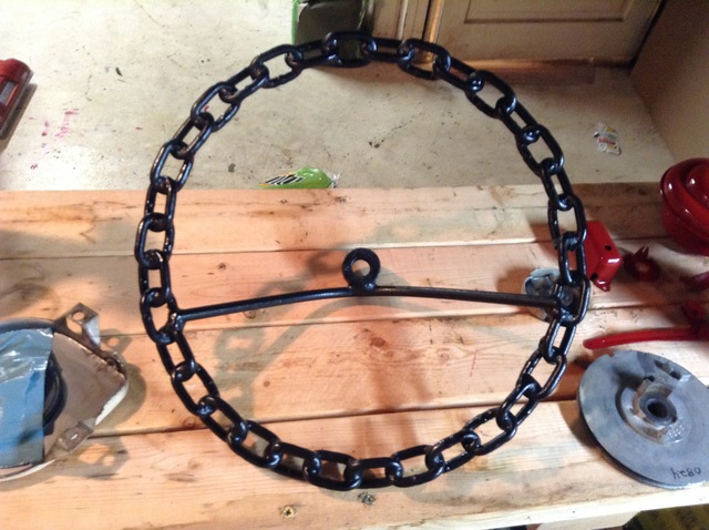

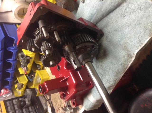

JamesC-120 204 #8 Posted July 1, 2016 (edited) I got the transmission all together today and painted all the steering and front axle and spindles. My original steering wheel was messed up and hacked up by somebody. So I made a chain steering wheel. It was actually really easy to make and I think it looks great. I'll have to see how much I like it once it's on the tractor. New rear tires are coming tomorrow!!! And fronts on the way! I used a small strap to hold it up and hooked it through a small hole on the back of the fenders. Edited July 1, 2016 by JamesC-120 1 Share this post Link to post Share on other sites

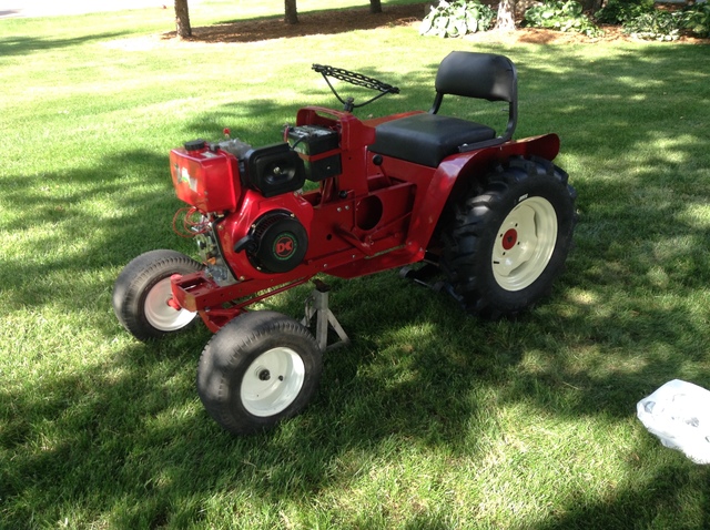

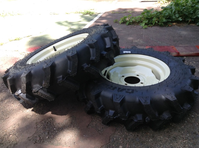

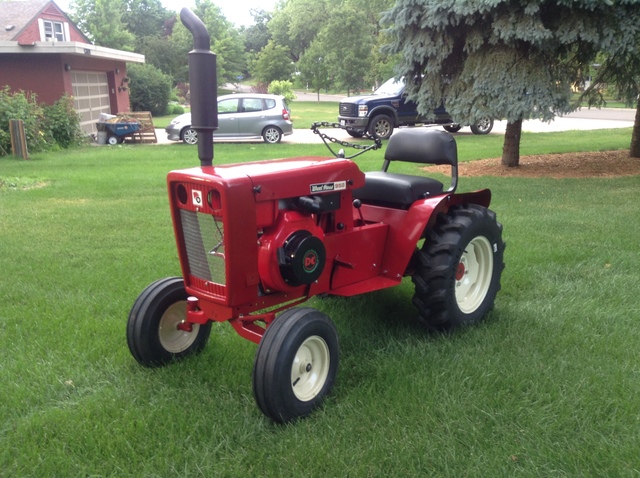

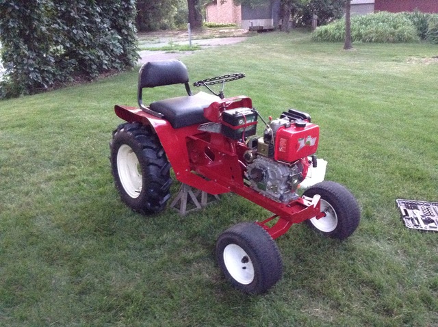

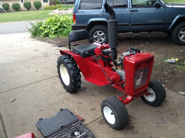

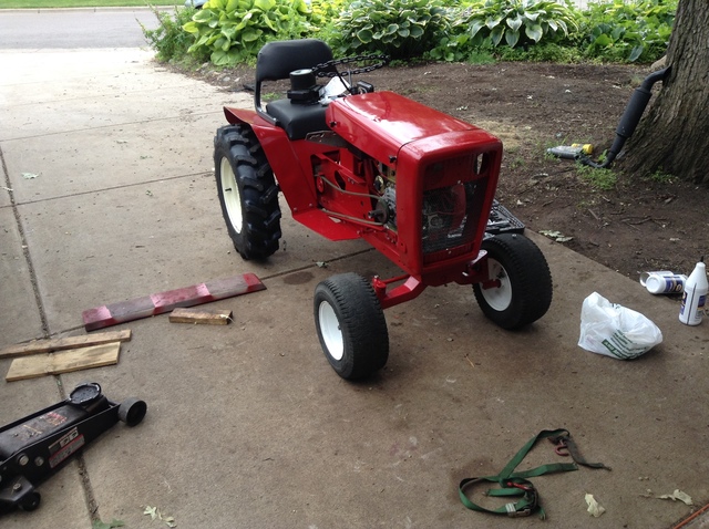

JamesC-120 204 #9 Posted July 2, 2016 (edited) Got my new tires today and got the engine mounted and wired in. Now I just need to put the trans in tomorrow but I can't drive it because I don't have all the seals yet. It's looking pretty good with those tires! The front tires are just extras I had for temporary use. Edited July 2, 2016 by JamesC-120 13 Share this post Link to post Share on other sites

mmmmmdonuts 274 #12 Posted July 2, 2016 Looks great James. I really like the chain steering wheel and the skinnier taller Ag tires. What size are they? 1 Share this post Link to post Share on other sites
rjg854 12,160 #13 Posted July 2, 2016 Really great job you've got going! 1 Share this post Link to post Share on other sites
JamesC-120 204 #14 Posted July 2, 2016 (edited) I was really never happy with any ag tires that were available for the 15" rim so I bought some 14" rims that look exactly the same as the old one and put 7-14 Carlisle farm specialists on them. The new tires are actually 1/2" shorter than the originals but they are about 1" wider. I really like the 1" tall lugs on these tires, they look great. Edited July 2, 2016 by JamesC-120 Share this post Link to post Share on other sites

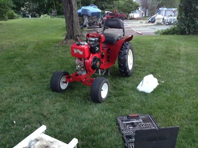

JamesC-120 204 #15 Posted July 4, 2016 I put the transmission in yesterday and painted the rest of the pieces except the hydraulic pump(still needs work). I will put it all together tomorrow except the rear hubs and tires because I do not have the seals yet. 10 Share this post Link to post Share on other sites

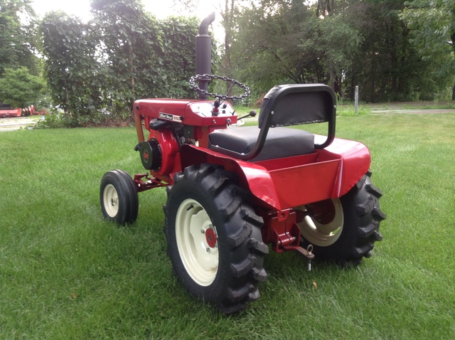

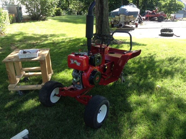

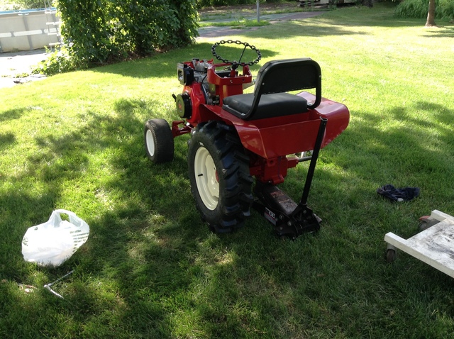

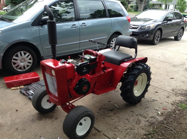

JamesC-120 204 #17 Posted July 4, 2016 Thanks for the manuals Gary. I'll start working on that soon. I got all the rest of the tractor together today and built my custom exhaust. Now I just need to build an air intake and find some new head lights. 8 Share this post Link to post Share on other sites
Pullstart 66,641 #18 Posted July 5, 2016 That's gonna be a great worker! Share this post Link to post Share on other sites
Terry M-(Moderator) 2,226 #19 Posted July 5, 2016 Looking good James! I'm liking those aggressive looking Ags on the back.. Share this post Link to post Share on other sites
WHX?? 51,705 #20 Posted July 5, 2016 Looks real good James, gonna be fun wearing the nubs off thise new tires. Motor looks like it fit in in there real nice too! Share this post Link to post Share on other sites

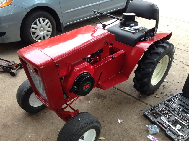

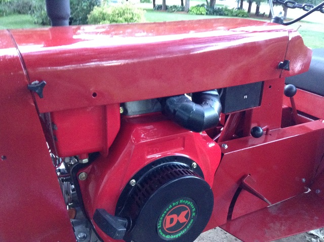

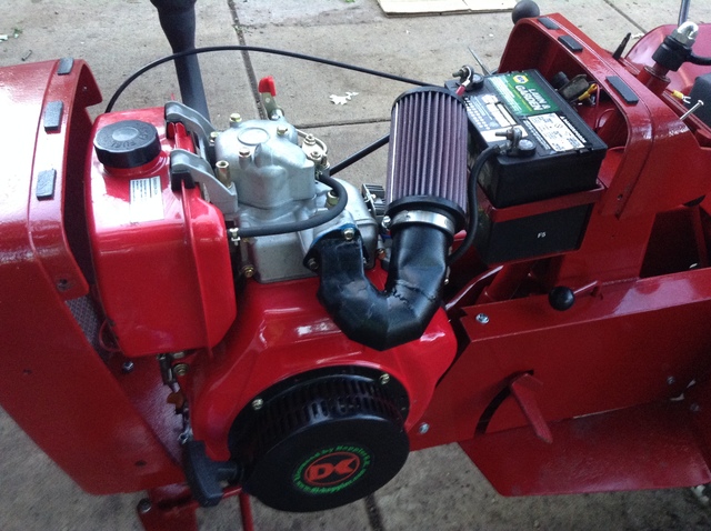

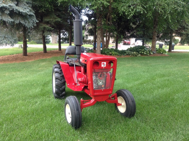

JamesC-120 204 #21 Posted July 8, 2016 I made my intake over the last couple days. I think it turned out great! I really like it. I also got the throttle hooked up and my new front tires showed up today. So they should be on by Saturday. And the decals are coming Saturday from redoyourhorse. Plus the new key switch is coming tomorrow. I took the hydraulic pump and cylinder apart and they all look great and in nice shape. So I will just paint and reseal. Do you guys know where to get new seals? Thanks 5 Share this post Link to post Share on other sites

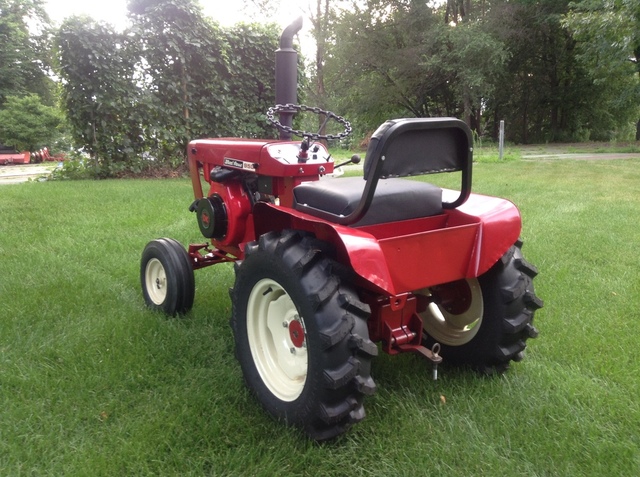

JamesC-120 204 #23 Posted July 11, 2016 I ordered the seals and got my new front tires and rims on. Also put on all the decals. All that is left now is hydraulics and headlights. 9 Share this post Link to post Share on other sites
JamesC-120 204 #24 Posted July 14, 2016 Got the hydraulics all finished and just need to mount the pump. I also ordered some new headlight lenses for the originals and a throttle knob. This tractor is a blast to drive and can't imagine not have a diesel. It rolls coal. 5 Share this post Link to post Share on other sites
