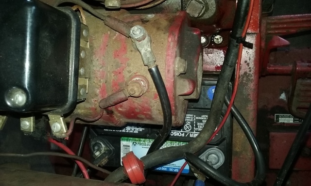

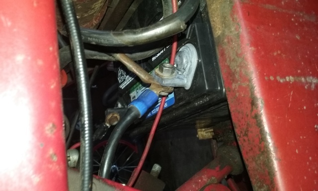

wheelh312-8 1 #1 Posted June 26, 2016 (edited) Now I have the engine together on to the wiring. My question is the 2 thick black wires off of the ignition switch, the long one I have running to the starter as seen in pic #1, in pic #2 I ran the the other shorter one to the neg battery terminal, and in pic#3 the frame ground run's to the battery also. I believe the shorter wire from the ign switch run's elsewhere but could not figure it out. The problem is when I turn the key there is no power, battery is new and fully charged checked with volt meter. Thank's Steve. Edited June 26, 2016 by wheelh312-8 Share this post Link to post Share on other sites

Achto 32,795 #3 Posted June 26, 2016 (edited) The short wire from the switch should be connected to the pos side of the battery, not neg. Need to complete the circuit, battery + to the switch then to the starter/gen. Edited June 26, 2016 by achto 1 Share this post Link to post Share on other sites

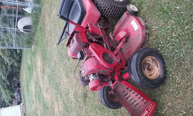

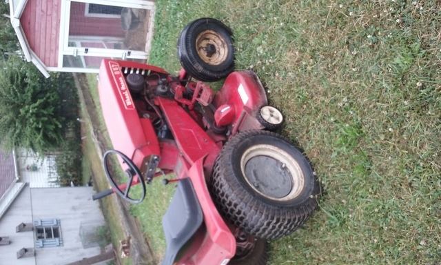

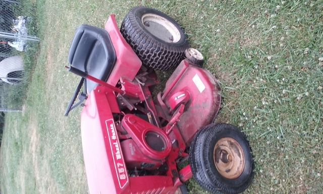

wheelh312-8 1 #6 Posted June 27, 2016 Well she is up and running, drives good and strong for the size of the tractor. Thank's for all the help it is greatly appreciated. The manual came in handy for some other thing's also good to have,thank's. Well here are a couple of pic's of it. Not sure why picture's keep getting turned to the side? 1 Share this post Link to post Share on other sites
