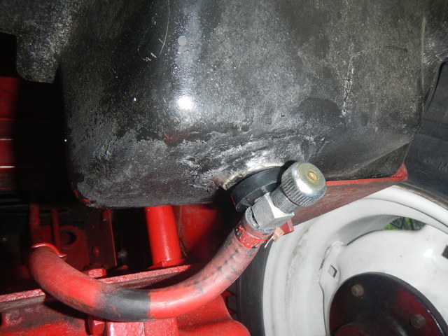

TimH 105 #6 Posted June 23, 2016 Is this what you need ? 1 Share this post Link to post Share on other sites

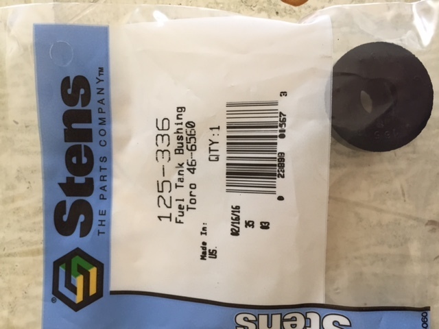

Southerncannuck 73 #9 Posted June 23, 2016 I was lucky that the local Toro store had the bushing and valve and even luckier that the hole in the tank hadn't been expanded. For the total cost of $12 I've got a shut off valve with filter and a new bushing. Why the previous owner didn't just fix it right given the low cost is mind boggling. I'll replace the hose asap. Anyone know off hand how long a piece I need? Louis 1 Share this post Link to post Share on other sites
