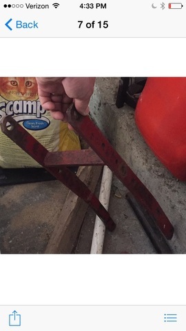

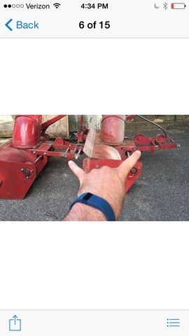

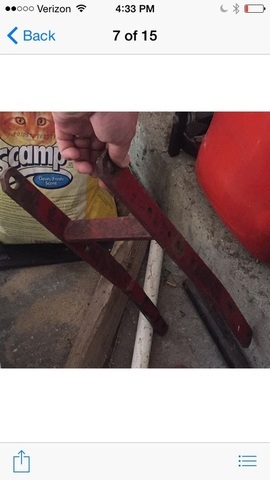

He's supplied me with the pics. I guess he said the brackets are interchangeable. Maybe if I put the bent one on it would help the angle?
stevasaurus
The blower will work on your 702 for sure.  The brackets are interchangeable.  Looks like a road trip to me.  :)  You will like the blower and if that is the difference between the brackets...go for it.  Make sure it comes with the flag...the parts that attach to the lift.  :)  I don't see the flag in your pictures.
    Actually, now that I look at your pictures...I have the bent bracket on my STR-324.

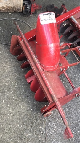

 There it's pictured. And thank you so much for your reply. What do you think the chances of getting one at the big show are. Cause I'm only an hour from that.
stevasaurus

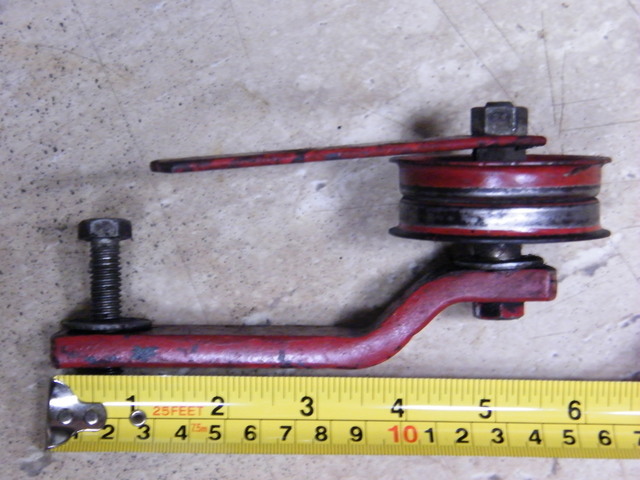

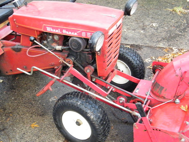

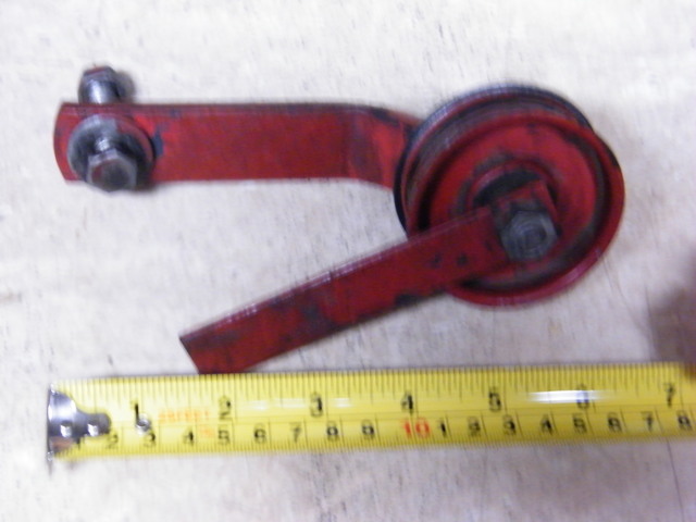

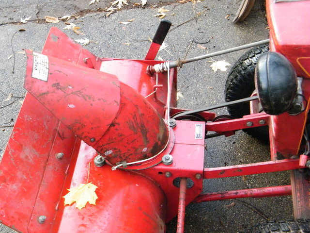

How much you giving for this...if you don't mind my asking??  It looks like a nice one.  In the last picture, the flag is laying on the barrel. :handgestures-thumbupright:  So everything is there.  Yes, there may be one at the show, but you never know if it would be as nice as the one you are looking at.  If this is under $300, it is a good deal.  There is a bracket and pulley that bolts onto the frame to guide the belt also.  I'll see if I have a picture of that.  It is the flat pulley with a bar guide on it...it is right behind the grille in the picture.
Here are pictures of that pulley set up.

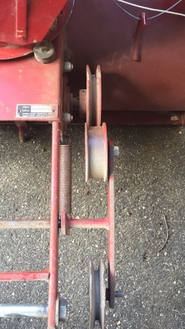

He also sent me this picture. I can't tell if that's right or not
He sent me a pic of him sprinting the auger and it spun freely for about 5-10 seconds so I guess it's got decent bearings.
  • Like 1
stevasaurus
That last picture looks a little different then mine.  Not sure it is a big deal.  This will work on your 702.  We can figure it out after you get it.  That picture is showing the tension pulley set up...maybe that is the difference between the Lawn Ranger STR and the 702 ST-324.  Fixable to make it work...may not even need to do anything.  :)
