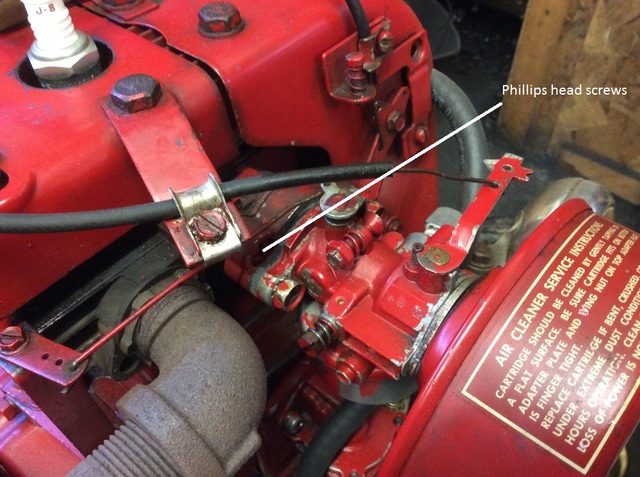

wallfish 18,624 #5 Posted June 18, 2016 The spacer between the carb and block should have small notches to allow a long phillips head screwdriver in there to remove the spacer from the block with the carb still on it. But you need to take the air cleaner off first. 1 Share this post Link to post Share on other sites
wallfish 18,624 #6 Posted June 19, 2016 Pic from another thread and it's not an H55D but they should be the same thing, unless yours has a Tolliston carb on it. The other screw is bottom right Share this post Link to post Share on other sites
