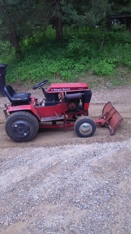

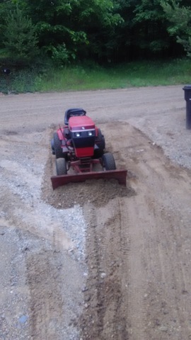

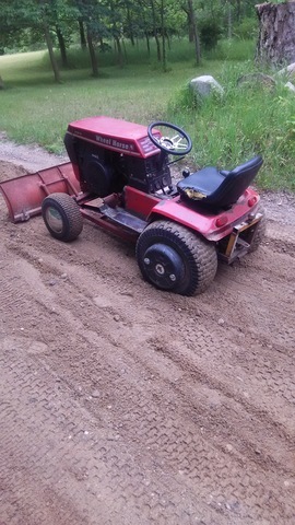

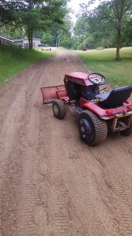

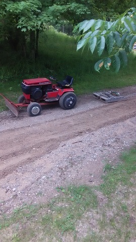

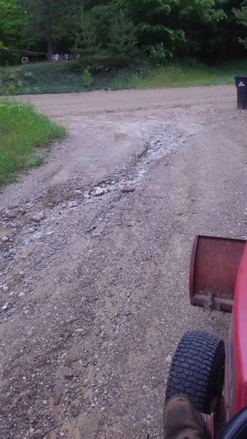

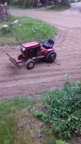

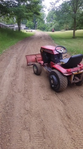

Wheelie again 158 #1 Posted June 16, 2016 Hi everyone I have had the electric lift off of a parts tractor on my 312_8 that I call old faithful for about a year now and thought I would let you all know what I think. To start this is the end of my drive today when I got home let's just say we got some rain LOL. So it was time to get to work. After attaching the dozer blade I went to it. The lift works amazing can't be out done by hydro or manual believe me I have those also and the electric is so precise and slow LOL. I want to go on record saying I do still like all three different lift styles they all shine at there own job. But when pushing dirt/gravel I like the electric. That said my biggest problem like always was traction. After using a drag/skid to put a nice smooth top on it was done all with horse power. Well that is my feelings on electric lift feel free to tell me what you think. P.S. I would not want to push snow with it I will leave that to the hydro and manual. 15 Share this post Link to post Share on other sites
Retired Wrencher 6,734 #2 Posted June 17, 2016 Wheelie again Looks like the old 312 did a good job for you. It feels good to have a tractor that you can do some work and not worry if you are going to break it because of cheap manufacturing. 2 Share this post Link to post Share on other sites
Tankman 3,528 #3 Posted June 17, 2016 Looks great but, wouldn't expect less from a Horse! Towing a skid? I have similar driveway problems. Spread and packed a tri-axle load of blacktop millings. Works great and no more washouts. 1 Share this post Link to post Share on other sites

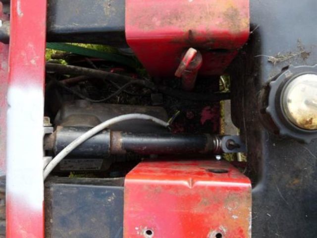

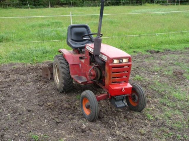

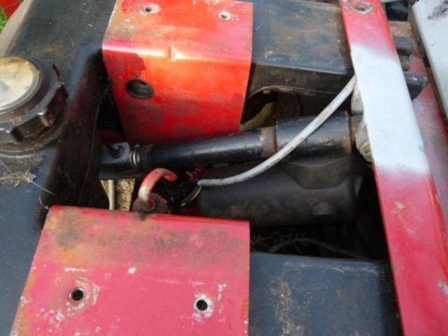

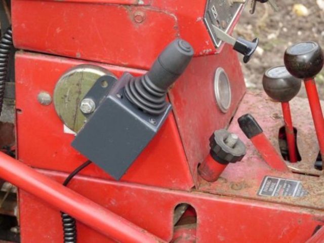

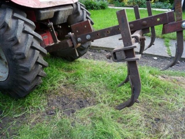

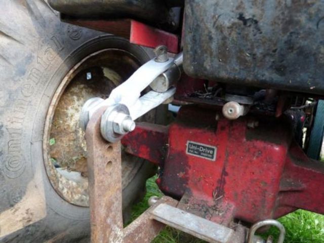

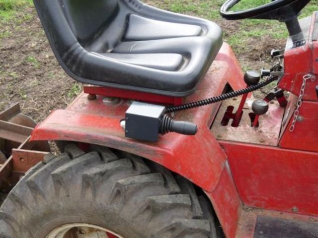

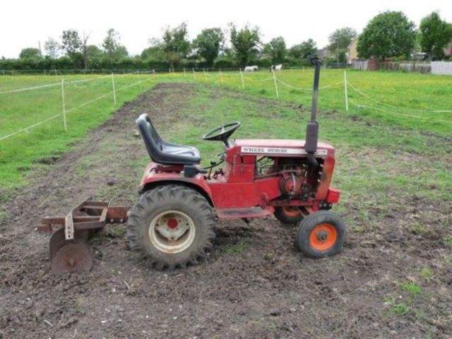

ranger 1,854 #4 Posted June 19, 2016 I hope I'm not 'high jacking' this post, but mention of the electric lift made me think that you may like to see my 'experiment'. A few weeks ago, using my C121, with cultivators on one of the horse paddocks, I managed to break the link to the rock shaft. Having some 're-cycled' linear actuators with failed feedback potentiometers, I thought I'd try one on the clevis hitch. Although 24 volts, they will work on 12 volts. push / pull force is listed as 2000n, around 450 lbs I think. I removed the rock shaft and welded a couple of lugs onto the fender support crosspiece, a short extension to the ram, and the unit fitted under the seat with room to spare. These units can be controlled by a simple double pole, double throw, switch, Not having one, I used a couple of 5 pin relays, advantage of using relays is, when not running, the motor terminals are joined together, providing/holding braking force if the load tries to move the actuator. Control is by a joystick, ( again re-cycled) this has a push button on top, which has to be pressed before anything else will operate. It has the power to lift the cultivators or discs, or me.Running it on 24v, it will lift the discs, and me. A magnet on the joystick box allows it to be mounted wherever convenient. The latest mod, is a link to allow 'floating' when down, and a 12v to 24v dc-dc converter, £10.00p from Hong Kong, via ebay. the next stage is a hydraulic cylinder in place of the linear actuator, the beauty of this is that it all fits without having to move the rear mounted fuel tank. I may fit bracing struts from the mounting 'lugs' down to the axle, but the crosspiece is stiffened by the 'sub frame' fitted to raise the fender for tyre (tire) clearance. 2 Share this post Link to post Share on other sites
