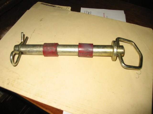

Devron30 22 #34 Posted June 19, 2016 Hey guys, I'm trying to remove the rear hitch so I can install my sleeve hitch. Any idea on how you get the big pin out that holds rear hitch on? Share this post Link to post Share on other sites
daveoman1966 3,882 #35 Posted June 19, 2016 If that pin is REALLY REALLY stuck....rusted to the trans case, you MAY have to drill it out. The pin is relatively soft and drills easily with a good drill bit(s). Cut it off flush with on each side, mark for center, then drill a 1/8 pilot hole, then open up to 1/4...1/2 etc progressively. (it'll probably break free with a 1/2 hole thru it. Don't hammer on it from either side...you'll flare-out the ends of it. I have used a round-point punch is my pneumatic hammer with success, after soaking it for a couple days in some rust penetrant. An acetylene torch to heat it up?...... dunno, never tried that. 4 Share this post Link to post Share on other sites
Devron30 22 #36 Posted June 20, 2016 On June 19, 2016 at 10:15 AM, daveoman1966 said: If that pin is REALLY REALLY stuck....rusted to the trans case, you MAY have to drill it out. The pin is relatively soft and drills easily with a good drill bit(s). Cut it off flush with on each side, mark for center, then drill a 1/8 pilot hole, then open up to 1/4...1/2 etc progressively. (it'll probably break free with a 1/2 hole thru it. Don't hammer on it from either side...you'll flare-out the ends of it. I have used a round-point punch is my pneumatic hammer with success, after soaking it for a couple days in some rust penetrant. An acetylene torch to heat it up?...... dunno, never tried that. Any idea where I can find a new bolt for this once I get it out? Thanks. Share this post Link to post Share on other sites
cleat 8,902 #37 Posted June 20, 2016 You can just go to TSC and get a 3/4" draw pin of the correct length. Never seize or grease it up so it comes out next time. 3 Share this post Link to post Share on other sites
Devron30 22 #38 Posted June 20, 2016 (edited) 20 minutes ago, cleat said: You can just go to TSC and get a 3/4" draw pin of the correct length. Never seize or grease it up so it comes out next time. Does it need to be a certain grade pin? Thanks Edited June 20, 2016 by Devron30 Share this post Link to post Share on other sites
cleat 8,902 #39 Posted June 20, 2016 Those draw pins are made for large farm tractors. I don't think a Wheel horse would break even the cheapest one they sell. 2 Share this post Link to post Share on other sites
roadapples 6,987 #41 Posted June 21, 2016 Are there "sirs" on here Share this post Link to post Share on other sites
daveoman1966 3,882 #42 Posted June 21, 2016 here is the TSC draw pin..... under $10 bux. (not the 2 red spacers though) it is 3/4" dia....about 6" long, or whatever you need...they have different sizes. 4 Share this post Link to post Share on other sites

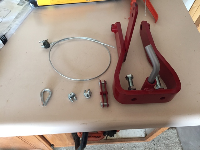

Devron30 22 #43 Posted June 22, 2016 Another question. How does this sleeve hitch hook up??? . I know where it hooks to the sleeve hitch itself, I just don't know how to attach the cable to the deck lever and attach all the cable pieces together. Mostly the red piece next to hitch. Thanks guys!! Share this post Link to post Share on other sites
