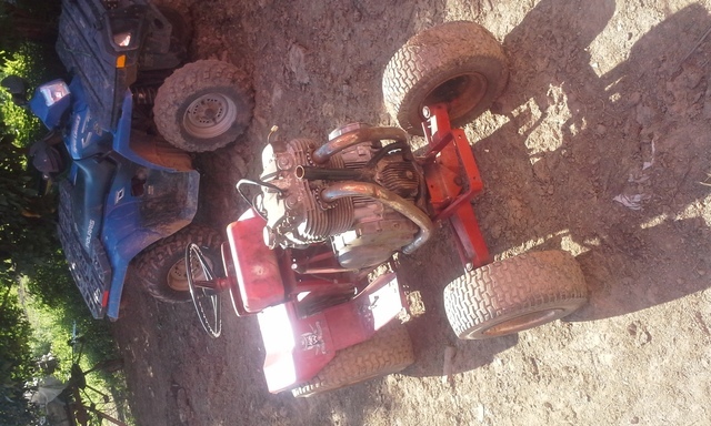

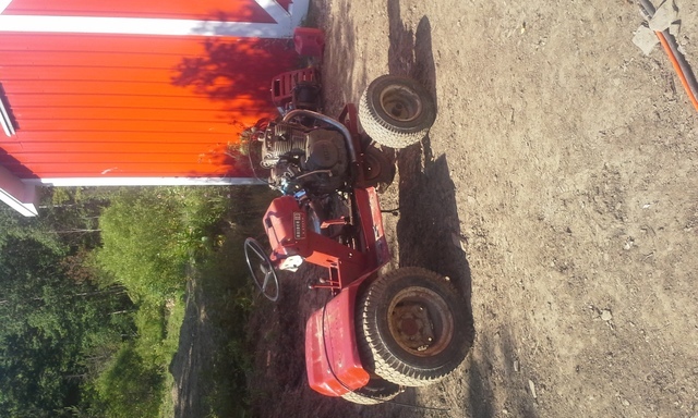

Levi 2 #1 Posted June 16, 2016 Hey fellas, I'm building a wheel horse raider 10 with a Yamaha 400 twin motorcycle engine in it and I was wondering if the transmission can hold that kind of torque. Any thoughts? Share this post Link to post Share on other sites

Levi 2 #6 Posted June 16, 2016 12 hours ago, Levi said: Ok thanks guys. I plan on going down the road with it at fairly high speeds and I wasn't sure about the torque or speed capabilities. I had pics on my phone of the build, but I lost them so I will have to get some more later. Share this post Link to post Share on other sites
