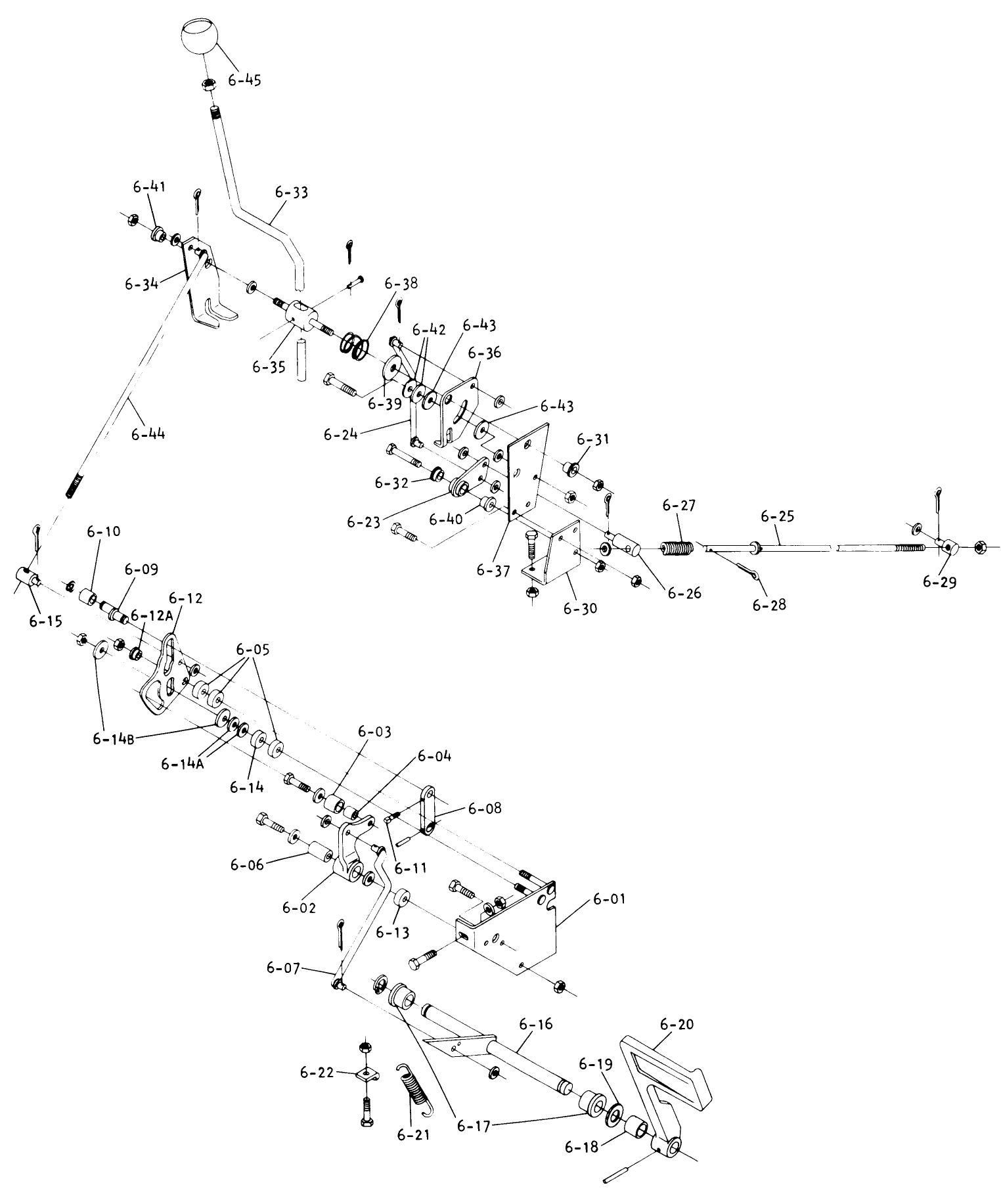

daveoman1966 3,884 #7 Posted June 14, 2016 What is the broken part you are looking for..... item # from this schematic: 1 Share this post Link to post Share on other sites
rorynate 1 #8 Posted June 14, 2016 Part # 6-35 is the part that broke or ended up in the gravel in my driveway buried somewhere in the whiterock. I can only see the pin missing from the parts breakdown. The shifter just sits loose in between the two brackets. The spring assembly is still seated. Thank you DAVEOMAN1966 Share this post Link to post Share on other sites
rorynate 1 #9 Posted June 14, 2016 I found the pin sheared off sitting inside of the hand control arm. I knocked it out with a small tapping chisel. Now I have to find the part or have a machine shop maybe make me one the exact dimensions.!!!!!!!!!!! Share this post Link to post Share on other sites
